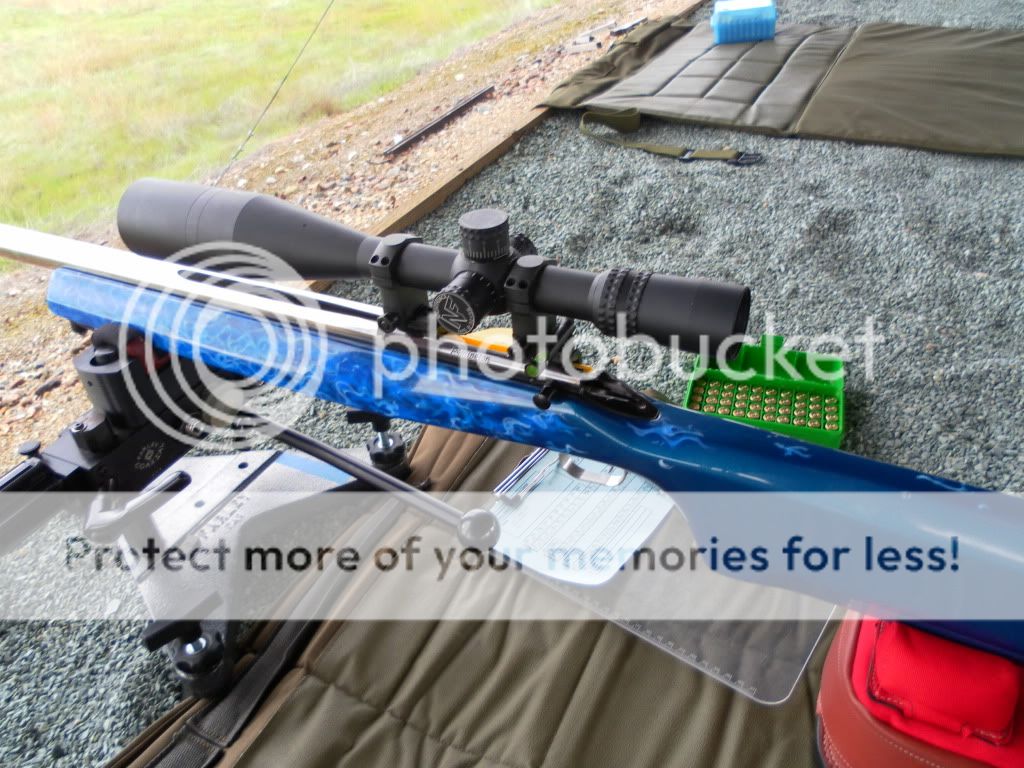

Joystick -- this style, popularized by the Farley design, is hard to beat. I personally have an original Farley and a Magnum Metal and have no particular preference between them. The joystick, properly adjusted with a solid rear bag, is the ultimate sighting machine for me. In Score shooting, they allow a quick dip down to the sighter, then right back up to target, and allow shooting to any position on the paper without any upset to the set-up.
If I had to shoot a match with either of these three set-ups, I would not feel any disadvantage. But my money goes for the "joystick" as the smoothest, most flexible system.
