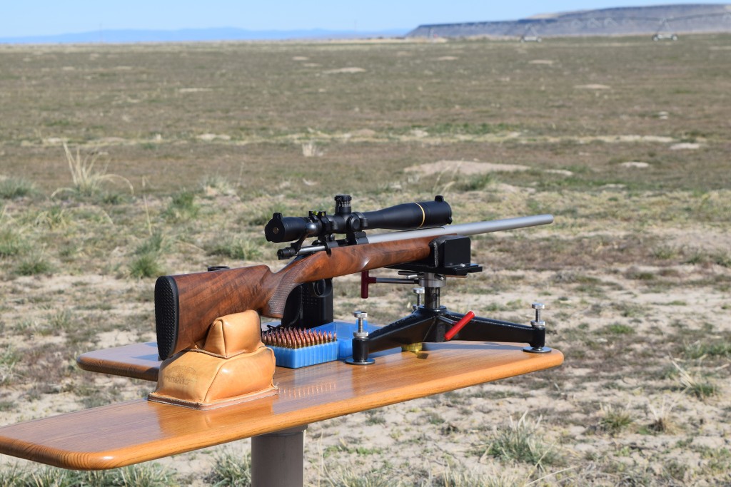

My most solid rest is front and rear supported. For shooting prairie dogs from a bench, I am rock solid with the table and rests shown below. For deer and antelope hunting, using a bipod with a rear rest is my best available rest. When I am mobile and in a state where you can rest off a vehicle, this is how I shoot.

For PD's and GS's in open fields, it almost always my rotating bench with CF rifles. Sometimes out the truck window on a window bag with custom 10-22's when it's not "bench weather". If the rifle of the day has QD studs, I remove them when I'm using my Sinclair front rest so as to not tear up the bags when at the bench. Most of my rifles intended for this do not have studs.

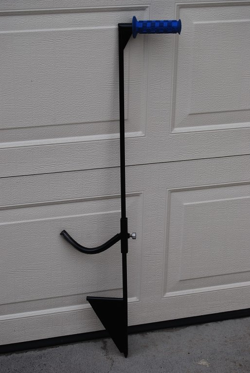

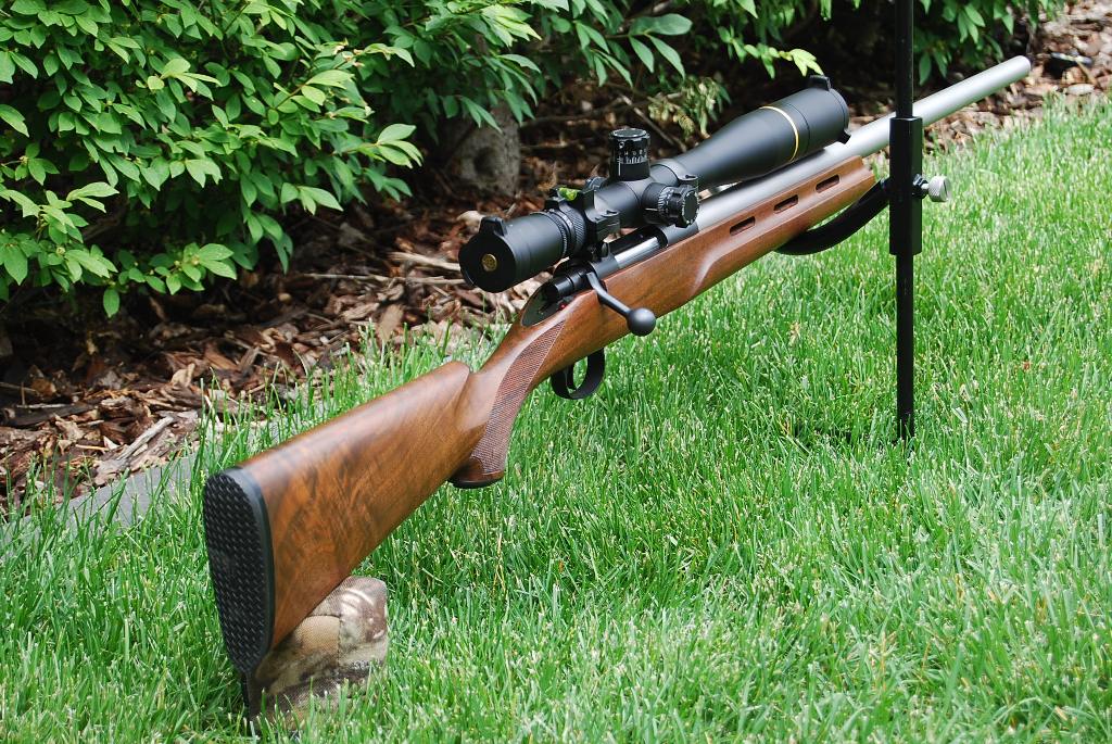

For rock chucks, it's sometimes a bipod or my "varmint stake" that works for prone, kneeling or sitting when I'm roaming about in the lava piles and juniper. I use this a lot for my rifles that lack QD studs.
A better look at the guts of the Varmint Stake:
I don't notice any change of accuracy or POI when using my bipods either, both seem to work just dandy, and the chucks don't seem to mind a bit.

As always great pics Mr Rick. Where might one buy a varmint stake...I like it!

Thanks. My son whipped out the Varmint Stake in his shop for me out of scrap material from a drawing I made. Pretty simple and not very hard to make. Here's a pic showing it overall in case you or anyone else wants to copy it for their own use.
