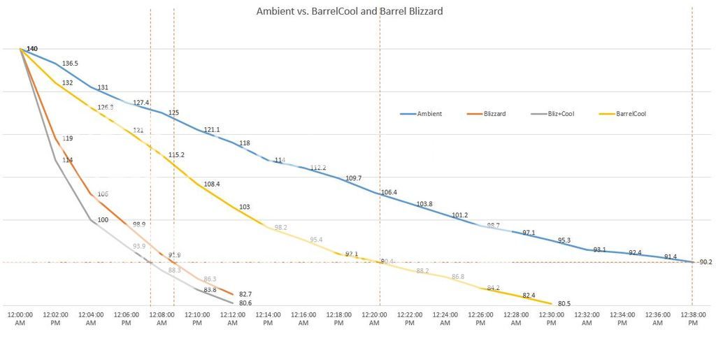

Repeated tests show Barrel Blizzard cutting times significantly from 45 minutes, down to less than 10 minutes. Pairing Blizzard with BarrelCool, you can get that hot barrel down to near ambient around 5 minutes. Save barrel life and prolong the accuracy of your rifle!

The idea behind Blizzard is to take advantage of the huge surface area of the barrel. By applying cooler, continuous air to the outside of the barrel, closest to the action, we observed through multiple tests that the barrel cools down rather significantly.
People have been doing this for some time with normal fans sitting on their bench, but we have figured out a way to place the fans so they are strategically blowing air in the critical part of the barrel, making it much more efficient.
