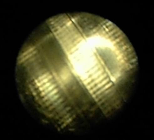

A friend of mine getting into F T/R bought a Model 12 F T/R rifle. He went to go clean it and in the process of cleaning it, started to put ever so small chatter marks on the lands of the rifling. I have no clue how he did it. Anyways, I went over and was looking at it with a flashlight about an inch from the end of the barrel and I can just make them out. They were not huge, but to the naked eye, it was there. No need to borescope it....

I looked at one of my barrels and I only have longitudinal lines that follow the rifling. His are small vertical marks on the lands themselves.
Came from factory like that.....but I assume he did not use a steel jag and pound it through the barrel though...LOL.
My bore scope shows chatter tooling marks on button pulled barrels all the time.
Unless it is hand lapped, the marks are a result of the manufacturing process.
Cleaning will not create the marks you see.

They were there originally. I had a Winchester barrel that looked horrible, full of reamer tracks that I was certain would become a tomato stake. Probably the most accurate factory barrel that I've ever seen.

My smooth looked at my savage barrel and said he had never seen anything that bad inside. Looked like railroad tracks with ridges like on side of interstate. He let me see them
bsumoba -
Every Savage barrel I've looked down is chattered and tool marked.
Some a little better and some worse then the picture above.
Tell your friend he's off the hook, and that Savage is why !.!.!

As the others have said, your friend did not cause the chatter marks. The barrel came that way and he did not notice them until after he cleaned it. Savages that I own, and have owned have had interesting bores to one degree or another. Tell him to shoot it for a couple of hundred rounds and see if the tendency to copper foul decreases with that use. I have a friend who has a Savage varmint rifle in .223 that shoots very well and does not have any unusual copper fouling issue, and yet its interior looks rather rough under bore scope inspection. I would leave it alone and continue to shoot it. You may need a more active copper solvent in the beginning, but that need may decrease over time. IMO, particularly in the case of a stainless barrel, the sharp corners of these kinds of features are the problem and they will probably dull with some shooting and cease to be an issue. What I have seen have not so much been chatter marks, but rather reamer tool marks that were not touched by the rifling button as is made its pass.
How does Savage manage to create chatter marks so badly with a button rifling process?
Those photos are interesting to say the least!
Just speculating here, but bare with me for a minute.
There are inherent differences in the level of production that Savage does and that of custom barrel makes...obviously. When button rifling a barrel, there are great pressures involved, but for varying reasons.
An overlooked aspect of the whys and hows of this are seen in the amount of pressure it takes to force a button through reamed blanks vs. reamed and honed blanks. A smoother finish to the bore carries less lube for the process of button rifling of gun barrels..as an example, as many makers are finding out...and creates more pressure to button. A larger reamed hole or a smaller button gives dissimilar results but still produce a barrel that acceptable to Savage and still performs well. If Savage deserves credit anywhere, it's well served for producing an accurate rifle for generally less cost than its competitors..although not as much so in recent years as they have evened the price gap to some degree.
That and the production levels of a huge factory rifle maker....along with their acceptable production tolerances as such,may well allow them to make a larger reamed hole that is likely faster and produces less tooling wear, during manufacturing...lowering production costs.
In other words, as I think Boyd said...the hole is too big for the button to iron out all of the roughness..but it still shoots. FWIW--Mike Ezell
