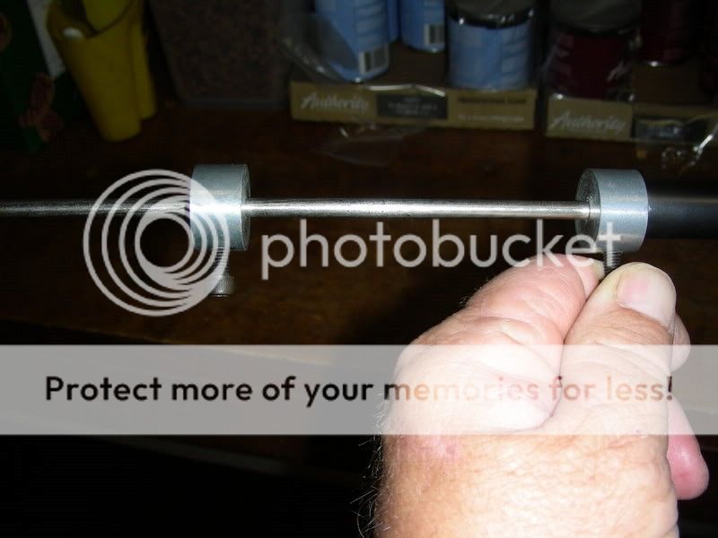

Best thing is to use is a rod with two sliding locks go from the end of the bore to the bolt face with one slide on the rod and set it push a bullet in the lands to where it stops add the other slide And stop it on the tip of the bullet . With two stops and some math using a caliper you got the exact distance . Larry
Bingo! That is exactly the setup I use and I can establish bullet touch distance within 1-2 thousandths. I got mine from a guy, and the stops are exactly .500" so I just measure the distance between (or outside measurement - 1.000"). Took a little while to develop the "feel" for the light pressure to use to seat the bullet to touch the lands. I use a wood dowel for this step. Very repeatable. I also can measure how much my throat erodes based on my records.
Yes I am measuring from the bullet tip, not the ogive. But I can easily convert using the standard bullets I have selected for my seating depth records.
