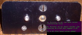

When the jaws are taken out and changed from big case head to small case head, the spring(s) can fly across the room.
I bought an extra jaw assembly, drilled and tapped for a screw that holds it all together.
I can now swap sizes in second while blindfolded.

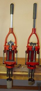

I just got a very old Bonanza co-ax press.
Things change a glacial pace at Forster.

>From Forster:
028271-046 WEAR PLATE $3.60
028271-037 SHELLHOLDER JAW HOUSING $14.80
001231 LOWER SHELLHOLDER JAWS--S(STANDARD)$29.60
028271-039 JAW PRESSURE SPRING (2) ea.$1.44
Instead of the Allen head screws now used to hold down the jaw assembly:
028271-020 10-24 X 5/8 INCH BUTTON HEAD SCREW (4) ea.$1.55
>From Enco:
4-40 flat top screw
#43 drill
4-40 tap
90 degree countersink drill
The screw captures the springs and jaws between the wear plate and housing.
The countersink hole in in the wear plate.
The threaded hole is in the housing.

I have had mine for over 26 years. Picked up another at a garage sale real cheap. I have no problem using a collet die or running the dies down against the shell plates. Several thousand of rounds over the years. The suggestion about screwing the plates together to keep the springs from flying is a good one. I will have to try that. The short handle works very well. I used a tubing cutter and shorten mine rather then buy a new one.
The semi circular .21" holes in the shellholder jaw housing is where the housing is weak, and can be bent by pulling a stuck case out of a sizer die. The bent housing tips cases so they miss the orifice of the die and smack into the base of the die, denting the case mouth.
The same hole is deep countersunk from the top, when it should be from the bottom. With the hole countersunk to accommodate the jaw opening screw. Then the jaws can open wider.
