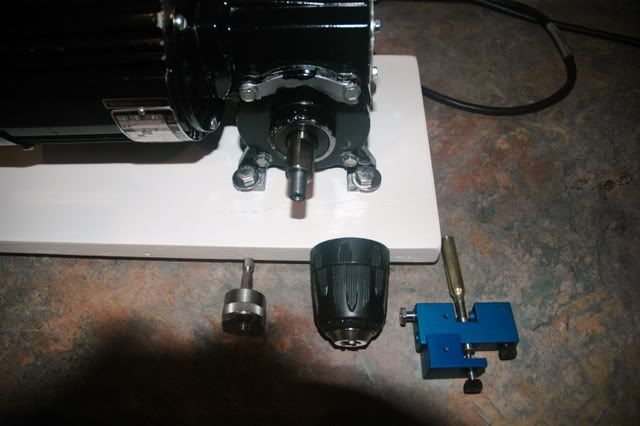

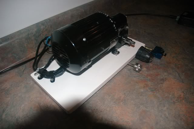

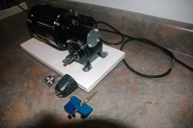

Had a question asto how mine was wired. So go topage 2. I included a picture of min wired for counter-clockwise rotation. Now this is how the instructions that came with mine said to do it. Your motor may have a different set of instructions.
Thanks for the tip on the gear motor, I had been looking a long time for one just like that. I also used your tip about changing the capacitor to the other side.
I pulled the shaft out of the gearbox and cut a 3/8-24 thread on it. I then screwed a keyless chuck directly to the shaft to keep the length to a minimum and concentric as possible.

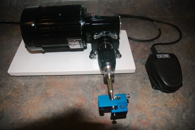

I then bought a Linemaster Clipper 635- S foot switch on ebay so I could have both hands free to work.
I appreciate the feedback. I also added a Linemaster foot pedal to mine. I just figured I had used up enough space with my little project.
I like the idea of threading the shaft. I don't have a lathe yet so I skipped that part. But I have a new chuck standing by for just such an application.

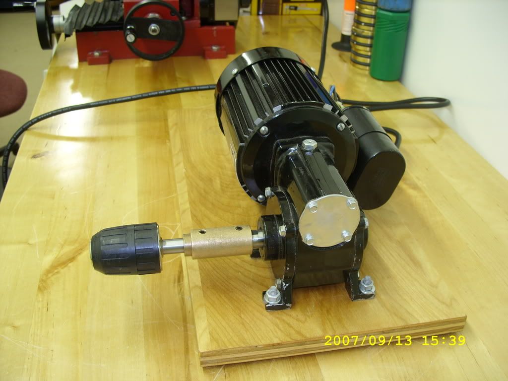

How about some photos?
Here are the pictures I promised to post when I finished my case turner. Basically what I did was change the capacitor to the non working side, Built a mounting board, removed the shaft and gear, turned the shaft down and cut a 3/8 - 24 thread on it and screwed on a drill chuck. I also installed a Linemaster foot switch so I could work hands free. Sorry the pictures are not better.
That is sweet! What did you use for your base? I can't wait until I get a lathe so I can tackle more operations. I do believe that threading the shaft will be near the top.
