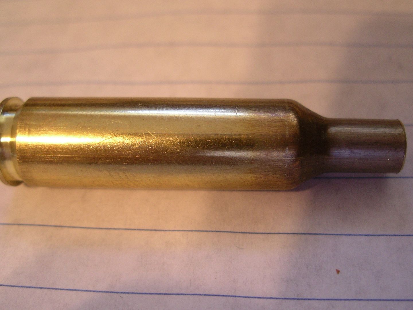

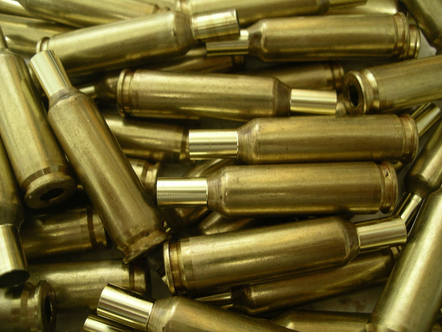

I made a project out of this chamber, made brass from Lapua 308 and 308 Palma. The brass when formed had a very long neck, about .113 longer than normal, so I ordered a PTG neck reamer only. I cut the neck .123 longer, then added .030 freebore only.
Two benefits from this, whole lot less freebore but the bullet is still out of the case a tad more than normal length with .105 freebore. Second advantage is somewhat a theory, turbulence point is changed. I may get longer barrel life from changing the turbulence point, but the short leade will really give me longer barrel life, that .113 longer neck is a sexy looking little cartridge.
Any pictures? Would love to see it.
Here are some freshly turned awaiting fire forming with 14g of Bullseye and House of Autry corn meal; these have large rifle primers formed from once fired Lapua 308 brass, and I would never recommend ever doing this due to web expansion in who knows what kind of chamber.
This one has not been fire formed yet either.
Here is palma brass formed and awaiting neck turning

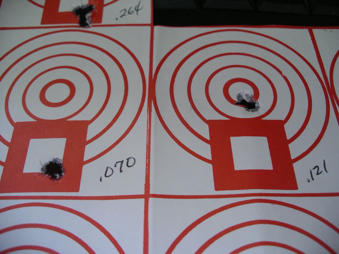

I am shooting a 31" 8Twist X caliber barrel, 39g of R#17 has no pressure issues at 3170, and 40g is 3270 105 A max, I would never have guessed that an A max would be capable of this kind of accuracy, probably should go and buy a lottery ticket. I am still in the development stages but 39g shoots as good as any 6PPC that I have ever owned, and that is a mouth full.
