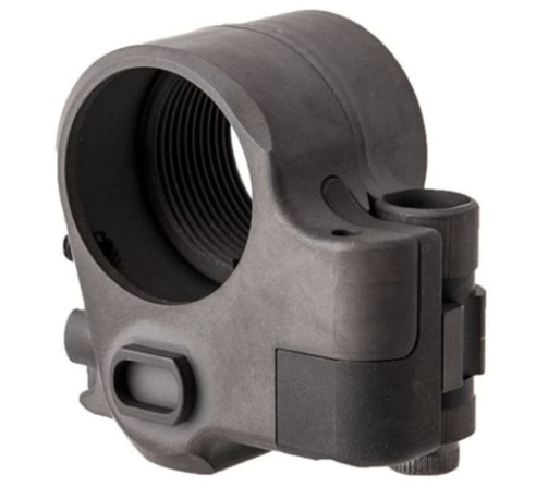

So with that in mind, I'm going to evaluate all of them. I'm purchasing every one I can find from my own wallet (so the results I publish will be unbiased) and will be borrowing what I can from buddies and anyone else I can get to loan a unit to me knowing the very real possibility that I'll break it. I'll be comparing them against the geniune Law Tactical unit which to me is the best of the units meant for use on gas guns. Why compare to a gas gun unit when we're more interested in bolt guns? Simple, gas gun units have to have a big hole in the middle for the buffer of an AR to operate in. When applied to a bolt gun you don't need that hole which means that there's more area for rigid lockup systems to be implemented or to do other things with. A FSA specific to a bolt gun has the distinct (in my eyes) advantage of being purpose designed and not being saddled with archaic non-functional features. So I'm going to compare the best of the non-purpose-designed options to the rest which includes purpose built bolt gun designs and purpose built gas gun designs.

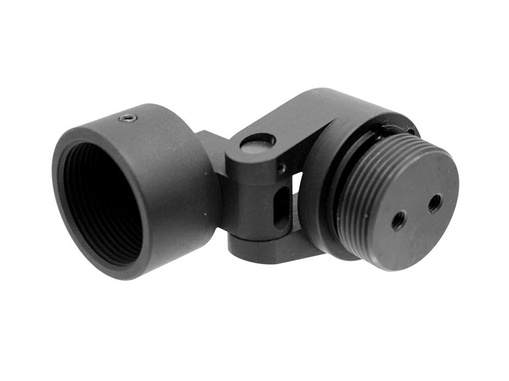

First thing first, the Law Tactical clone from Farcebook (pics below).
Unit cost $53 plus shipping and arrived in about 5 weeks shipped from New York with Chinese writing on the label and on the Paypal invoice. They are fraudulently listing "Clothing" as the category of stuff they sell so we also know that honesty isn't in their lexicon. It was an obvious reship from China to New York and from New York to California. Kinda an odd route to ship through but, ok.

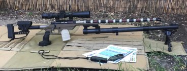

I installed this on my Deadpool rifle which is a Savage 10 action with an aftermarket 6XC pipe in an MDT LSS chassis. Fix the chassis on one side and the XLR Industries Tactical butt stock to the other. It did not come with either instructions or the tool to tighten down the chassis side thread insert like Law Tactical provides so I had to use Youtube, a hammer and a screwdriver.
Once installed and set in the closed postion, I opened it and then tried to close it gently and it did not want to close. I pushed the button and it closed. I opened it again and tried to snap it closed and it wouldn't close, tried again and again and then broke the tip off of the locking hasp. Pot metal garbage. I left it on to go teach a student how to properly get behind a rifle and a thought hit me. I can use this to teach him about "the pocket". Turns out a broken FSA makes a good way to teach about recoil forces being kept inline to the shooter's spine.
Pictured is the FSA as advertised, the part that broke and the bolt gun being used for testing. I also will be testing anything that can work on a gas gun on my M4 profile AR-15. This unit did not survive on a bolt gun long enough to test on a gas gun.

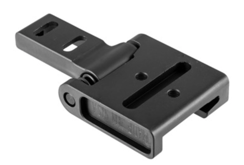

I've ordered the XLR Industries folding stock adapter and the UTG unit already and in 10 days (hey, dude's gotta get paid first) I'll order the MDT unit and the Sylvan unit (no Christmas this year since the kids moved away so present money is folding stock adapter money).

Law Tactical - Baseline. As good as a gas gun unit gets. 19/20

MDT: Ordered 11/10. Arrived 10/13. Excellent 16.75/20
