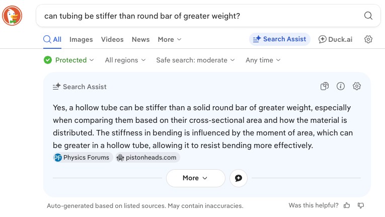

Well, I'm not an engineer or scientist or gunsmith, but I always heard that a fluted barrel was "as stiff" as its unfluted earlier self ... kind of in the same way that tubing is stiffer than round bar of equal or even greater weight (since tubing of the same weight will have a larger diameter)...so it's not purely a matter of mass...if I'm reading this stuff right...
This is what the DuckDuckGo AI brain surgeons say FWIW:
In barrels of equal weight the fluted barrel is stiffer. This not a comparison of tubing vs solid round stock.
