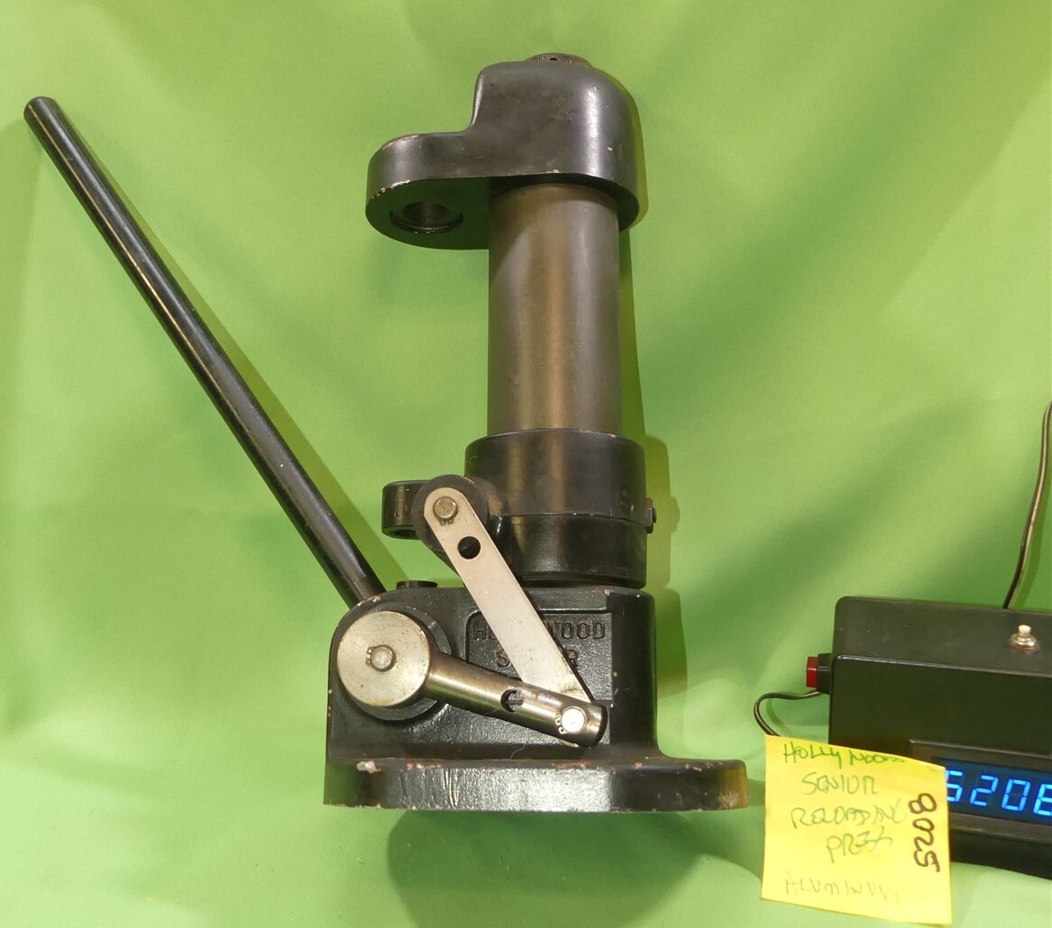

I use a pair of these......Hollywood Senior......Amazingly smooth and like most presses, paired with quality dies your ammo will be all it can be....I pulled this pic from the internet.
