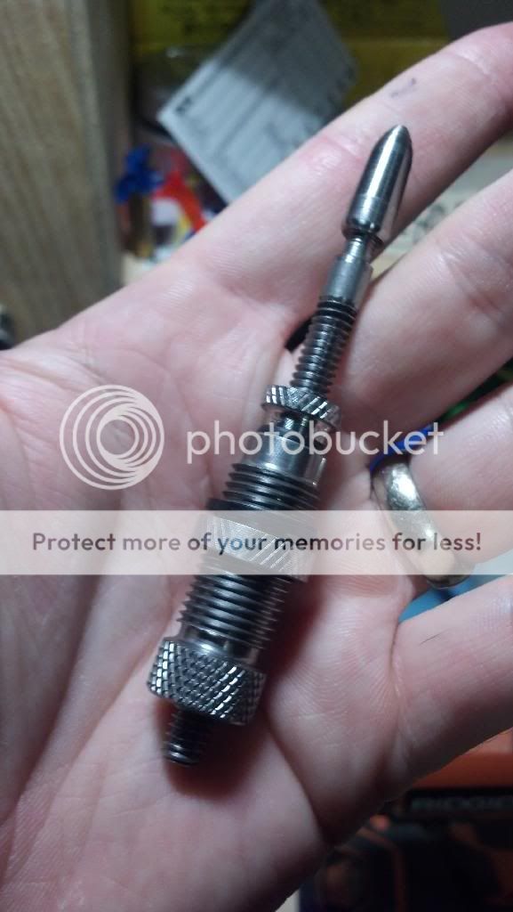

i'm using the COAx press so the die floats. Also Whidden's new decapping unit utilizes 2 rubber washers. Here is a pic of his new unit
