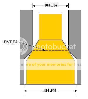

You need to come up with a way to measure the distance from the shoulder to the case head. Hornady sells an overpriced kit or if you have access to a lathe you can make a little bushing as in the picture below. Once you have a tool that allows you to precisely measure the shoulder then you can properly adjust the sizing die to bump the shoulder back a thou or 2 [ .001 or .002" ].

First, buy yourself a decent tool for checking headspace. The Stoney Point is fine, the RCBS micrometer case gages are kind'a slick, but even just a decent caliper and any kind of bushing that fits on the shoulder will work well.
With new brass, unless it won't chamber, just load it and shoot it. With fired brass, if it will still chamber fine, you can just back your die out a few complete turns so that it doesn't size the side of the case and push the shoulder forward. This is kind of a half-a$$ed neck sizing, but it seems to work okay.
When your bolt gets hard to close, then you can set your die up better. Measure your case like it's shown in the picture rayjay added. Then start turning your sizing die down until you bump the shoulder back about .001" to .002". It will probably get longer as you start to get close. Depending on your chamber and die, the die might can start to squeeze the sides of the case before it hits the shoulder.
I do have a lathe but have never used or seen a headspace gage. Will the enclosed sketch work for a 6.5-284 or should the major diameter be a counterbore?
Here is a pic of the underside of the headspace measuring tool that Harrell's supplies with their sizing die. Notice that the tool has a section that corresponds to the shoulder of the case. The tool needs to be longer than the neck.
