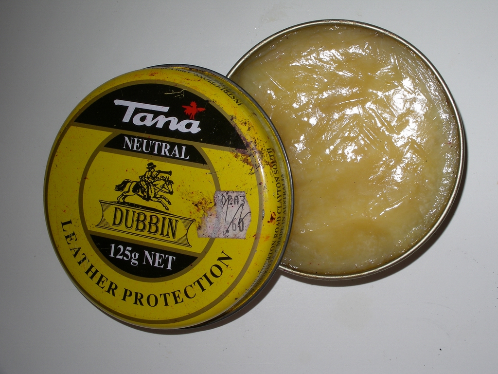

That sounds awfully close to a recipe for Dubbin/Dubbing. It was used by the military around WW2 as a preservative/waterproofing on combat boots and other leather goods. And has been around for a much longer time
