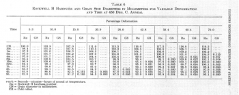

The University of ILL published charts for various temp. The below chart shows what going on. They used small cold rolled coupons. Constant temp in a furnace. If it doesn't anneal in 30 sec or 2 mintes in a furnace it's not going to flash anneal where you go up to temp and remove the heat. It's only at max temp for a fraction of a second.
It can get confusing there are many hardness scales used to report data. Just look at the trends.
The chart is for 450C=842F. Time is total time in the furnace.
