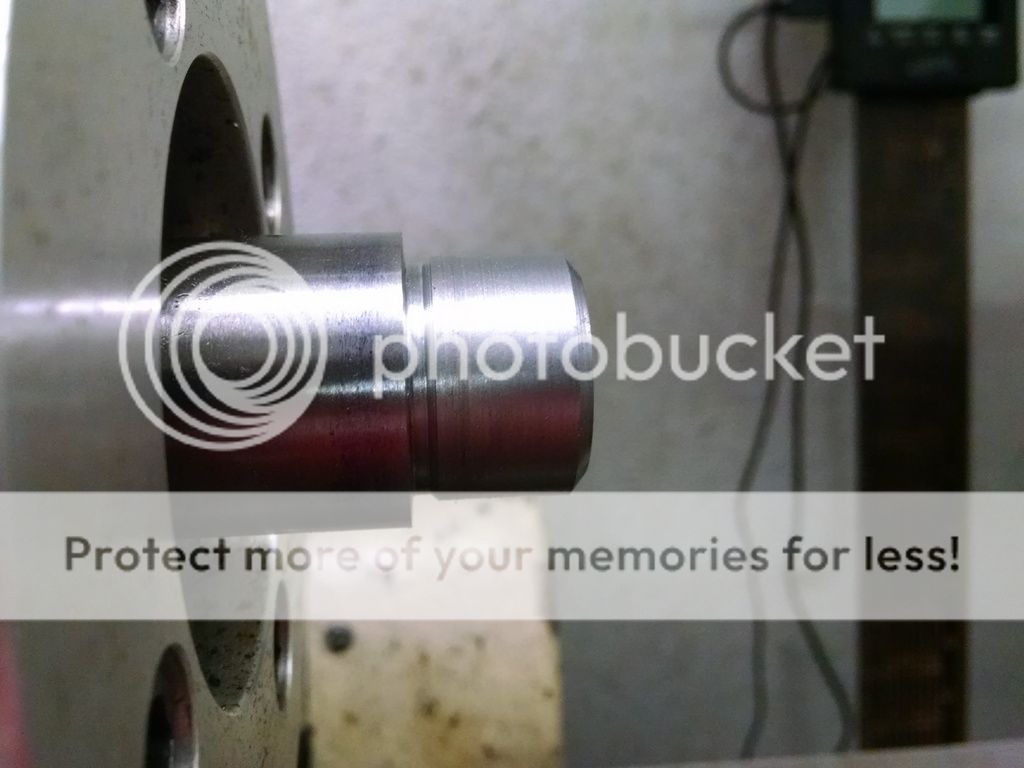

First rebarrel job 6.5-06 M70
I finally got all my ducks in a row after many hours of practice and buying tooling. First barrel to practice was a cheap green mountain 6.5mm barrel will be finished at 25.5", threaded 1" 16tpi for a M70 LA. I have a few more kinks to work out with my flush system before chambering it in 6.5-06 but hopefully next week ill get it chanmbered and crowned.
I built the outboard spider and used a bald eagle spider plate on the spindle. I used a range rod and dialed the barrel into .0004" TIR, took me about 4hours total so i called it good at .0004"TIR. Turned down the tenon to .995" then threaded it 16tpi. Came back and squared up the shoulder with a sharp threading insert to get rid of the small radius my HSS cutter left. I think it turned out pretty good.

If I wasn't making a sizable chunk of change doing gunsmith machining I probably wouldn't have set-up a flush system. Have that solid pilot reamer altered for removable pilots (Dave Mansons' turnaround time was about 2 weeks, last time I checked). You'd be surprised how much damage a solid pilot reamer can do to the rifling just ahead of the throat. I pre-bore so that the pilot has about 1/8" engagement with the bore and the shoulder (of the reamer) is engaged with the barrel. IMO, pre-boring is not so much about wear on your tooling as it is being lined-up directly with the bore. Others may disagree, that's JMO.
I fully understand what your saying with the pre boring to make it concentric, but can you tell a difference? I'm using a jgs floating reamer holder so will it matter?
I'm not familiar with the JGS reamer holder, so I don't know. That's the way we were taught in gunsmithing school 24 yrs. ago. We 'dialed in' with long reach indicators as grizzley rods hadn't come to be, then. I do know that I don't care for a 'spider' in place of a qulity made and mounted 4 jaw chuck. Maybe I'm uninformed or just not up on the "latest and greatest", but it looks like a prime opportunity for the barrel to slip,,,,, and once it slips.......... Looks more like gimick to me, instead of straight forward machining practice. But, what do I know...........
