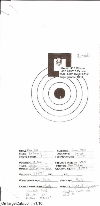

It's not the most popular powder for this cartridge, H4831sc is though. I like the H1000 because it's cooler and hence gives me a longer barrel life. here's how mine does at 100yds during a load test. Very low ES/SD's. I'm not doing any weight sorting or bearing surface sorting. Just load and go.
This is 3 shots, i know some like the 5, but i find it a waste of coyote ammo if I shoot more than 3 at paper. ;)

I'm mag feeding mine. I'm went with the short throated reamer for the 105 class bullets. I'm using the Berger 105 hunting vld and i'm just setting to mag length and jumping them. They work just fine. Picked up a group the other morning at .114" they shoot just fine. I'm not shooting a bench gun either, just a hunting rig with a med palma barrel, not to heavy, it's one of my coyote rigs.
