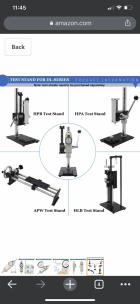

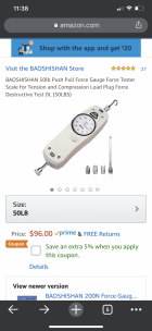

I bet a person could buy a simple spring force gauge to keep track of your FP strength over time. Have a bunch of different scales on Amazon. Test a new spring right away to get a baseline and check it however often you want to see if it’s losing strength. Might save you money on new springs or might cost you more money than planned. Would just have to use it and see.
This one seems to have good reviews. Can even buy an arbor press stand with DRO stroke length gauge for it.
