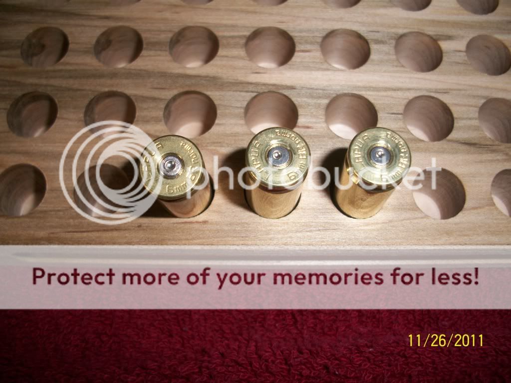

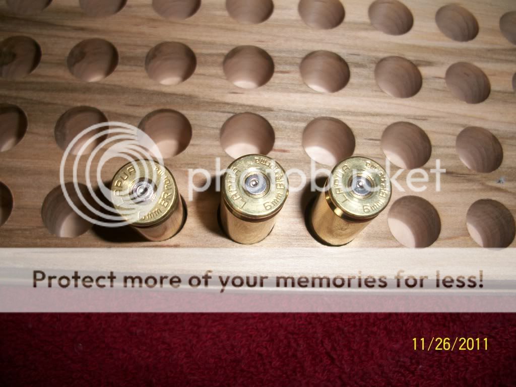

Sorry I'm late to my party here. I've been toying around with the gun. I did check the headspace and that did not change, and I also checked the lands again to make sure I was still jamming the bullets the same as before, which that didn't change either. The only thing that I could really lean on as being the culprit was the primer ignition now being more intense from the smaller FP was changing the pressures enough to make my gun not like it. When I stated earlier that the 205m's weren't that popular, I didn't mean in general I was saying that they are not really the 'go to' for the Dasher's.
I still can't figure out the flatten primers, the smith said he didn't think that was much to worry about as long as I didn't see any ejector marks and said that the energy that was pushing the primer back into the FP hole before is now just being transferred across the bolt face since it has no where else to go. But I did see a few that showed a very slight blemish of the ejector - that was with my original load prior to the FP bushing . So I wanted to make a decent size change in pressure thats why I went down to 30.5 - 31 grs which is a very light load for the Dasher with 105gr. bullets. I still get the flatten primers, and it hasn't seemed to make to pockets loose, but I doubt I'll get the life out of the brass as I would have before. But I can't see going much less than 30.5grs.

The one on the left was fired prior to the bushing, also notice the now bushed FP strike is slightly off center.
