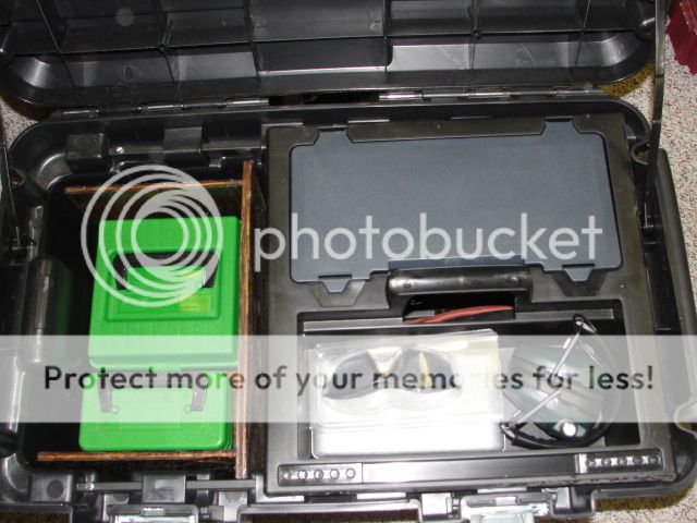

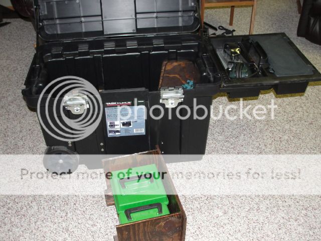

I wanted a tote on wheels so I could have everything sealed up. I looked all over and Found the perfect tote at Lowe's. It is a Task Force brand Heavy Duty Tool Chest on wheels with a strong metal handle and latches. Also, I brought my Sinclair rest into the store to test fit and the reinforcement ridges in the tote fit a Sinclair rest with F class feet perfectly! It comes with a removable tray with one side that has a lid. The tray can also be set on the handle instead of the ground.

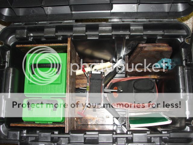

First thing I did was make two compartments in front of the rest to keep it from popping out of the ridges and also for storage. In one, I store rear bag risers and shooting mat stakes. In the other, I can put a notebook or what ever else I might need that is tall and skinny.

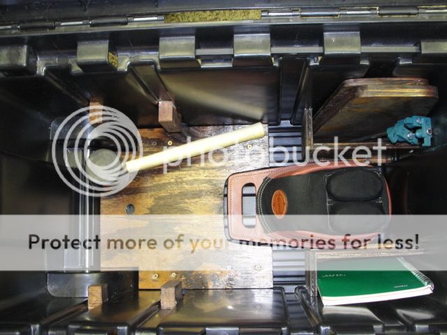

Then I made a false floor that came up right behind the rest feet to keep it from popping out backwards. I cut a notch into the floor so the rear bag can sit between the front compartments and under the rest. A hole was drilled for the rear foot on the rest to set into to also add more stability.
Then I made a removable compartment above the rest that can hold 1, 100 round and 1, 50 round ammo boxes.
