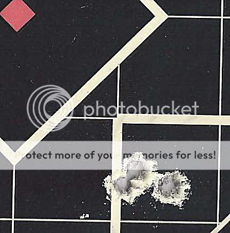

Ok, it was just rebarrelling a Savage 12FV which is not really gunsmithing, but for someone as mechanically inept as me it's an accomplishment. I installed a Lothar Walther 28", 8 twist .243 Winchester barrel along with a 20 MOA scope base. The stock is a LVT from SSS which they pillar bedded, trigger is the standard accutrigger.
I ran some factory rounds through it last weekend for the breakin which shot decent, then loaded a bunch of 95 gr. Berger VLD's to try yesterday. I had tried to shoot these in my factory barrel and never got a group less than about 2" at 100. The final load I shot yesterday was 41.5 grains of H4350, it gave me .135" vertical (at 100 yards), and I wasn't too worried about the horizontal since the wind was blowing prety good right to left.
The next trip I will use 5 shot groups with .2 grain increments and go from 41.4-42.4 grains (Bergers max load).

Believe me Ourway, I was nervous doing this the first time, I probably rechecked the head space 7-8 times before screwing the nut down tight, then I checked it a couple of more times. I only used a go gauge, I turned the barrel in until it hit the go gauge, then barely backed it off. I then put a single layer of tape on the back of the go gauge and the bolt would not close, in fact it barely would start to move down at all. After repeating a bunch of times I screwed the barrel nut down and tried the same routine again. Factory rounds chamber easily as well as new Lapua brass and some resized Lapua so I felt ok with it.
If I can do it even a caveman can do it.
