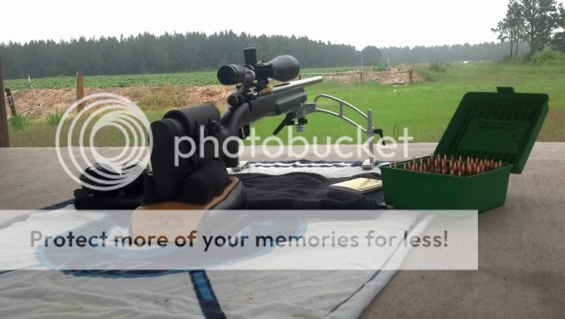

Just got my barrel back and got to the range to shoot it. Have not shot in almost 2 months
Decided to go out and shoot ladder test at 600 yards using a new powder. This is a 308 win with a 22" barrel
Here is the first round of ladder test that shows the low node
Here is the low node repeated on the second round ladder test
Here is the high node
It appears the low node really has potential as it repeated itself. The ammount of vertical and the actual group size of 3 shots which are all different loads show it is promising
Go with the seating depth.At 600 under a half minute of angle is pretty darn good to me.
