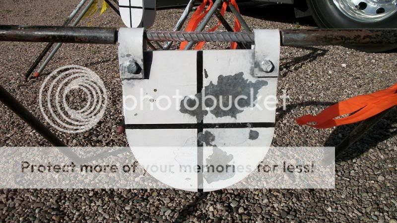

Something like this (3/8" AR500, 8" diameter, holes not within the 8") will work and is very portable so it can easily be moved from one yardage to another.
Then after hitting the steel a few times, white spray paint and a broad magic marker restore it to like new. This is a 5 shot group shot at 560 yards. The POIs are hard to see in the photo but for F Class proportions, the five shots would have been five 10s with three Xs.
