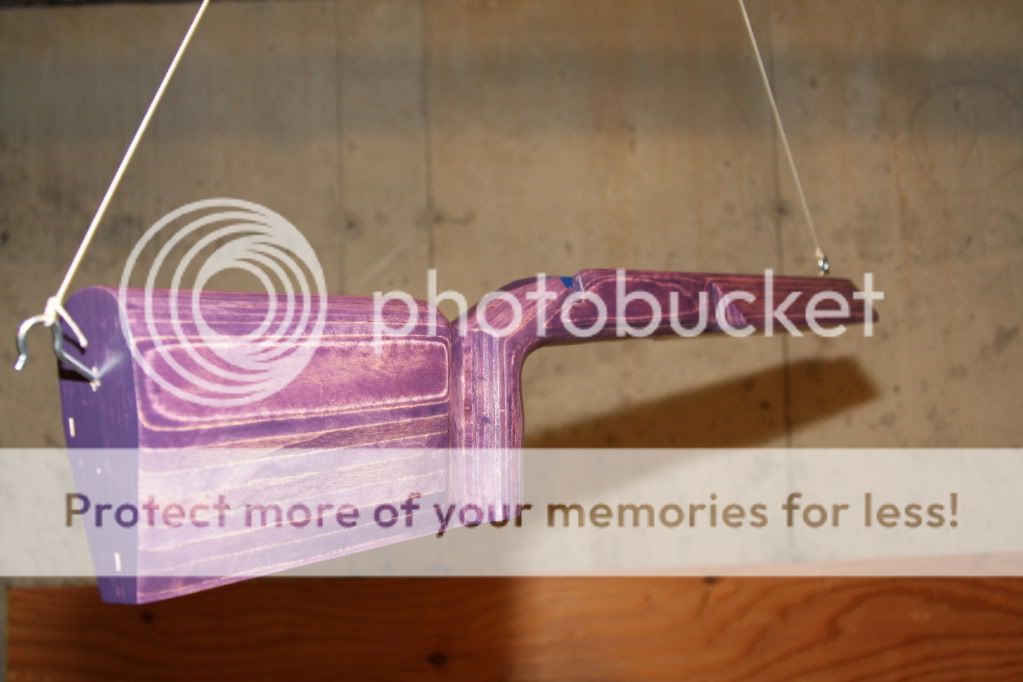

Final Photos! - Decided to try making a HBR Stock.

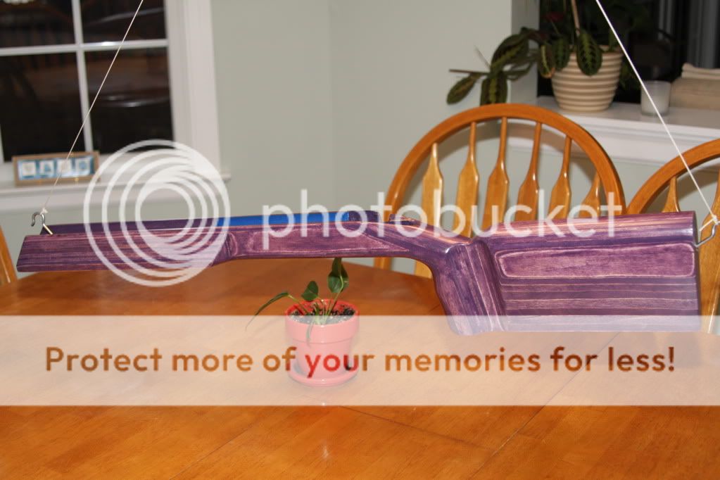

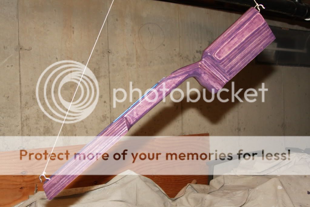

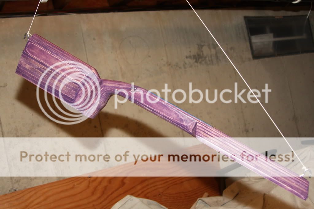

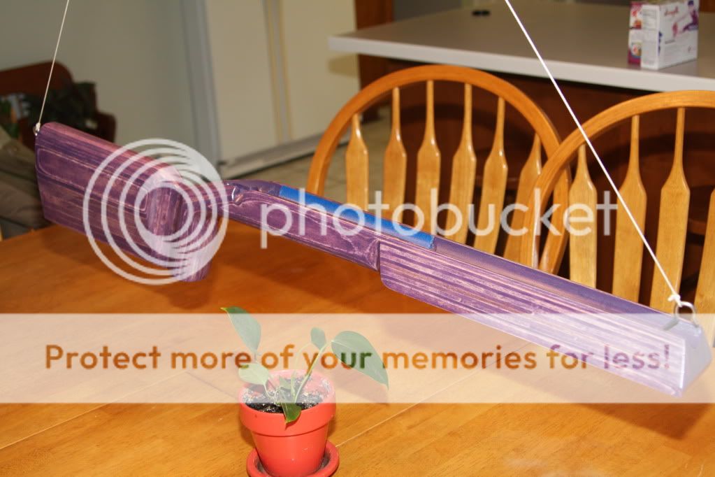

Re: Trigger inlet and stain - Decided to try making a HBR Stock. Bored!

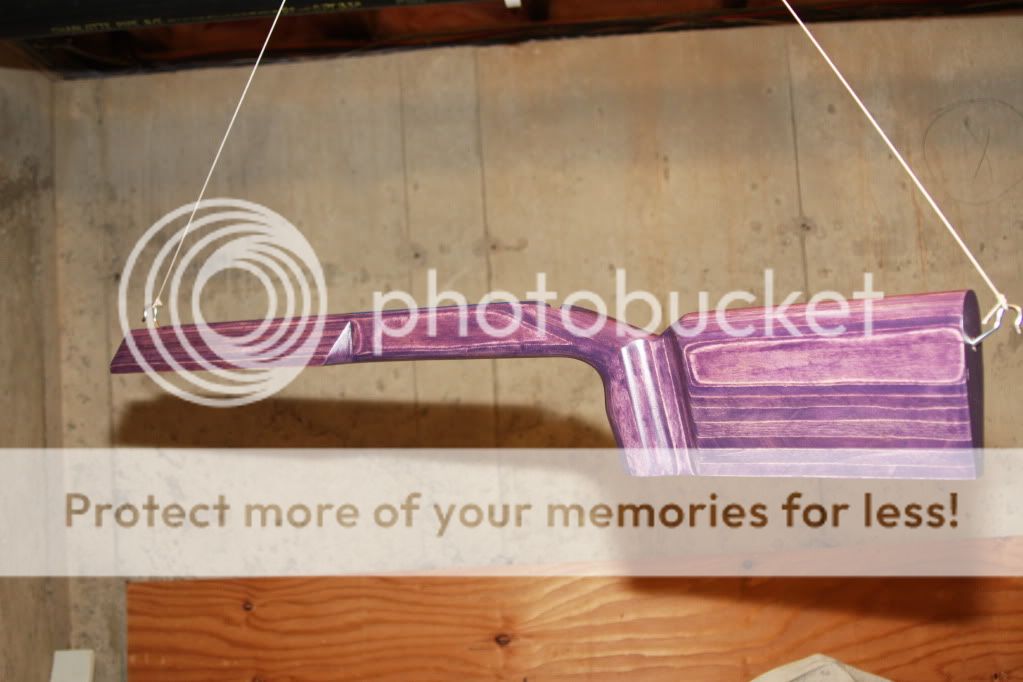

It's hanging down the basement now waiting for the stain to dry completely. I though about using a DuraPearl top coat, but I'm just going to use a spray on Urethane to finish it off. I don't want to spend too much more time on this one. I'm already looking forward to building a few more of these with a higher quality plywood.
Re: It's done! - Photos added. Decided to try making a HBR Stock.
Looks pretty good for a first attempt!
Two suggestions:
You can buy pretty decent baltic birch ply at Home Depot for about $40 for a 4'x4' sheet. Ought to be enough in a 3/4" sheet to laminate a couple of stock blanks & you can cut out the voids/overlaps/irregular layers.
While you're there take a look in paint section for any kind of sanding sealer, preferably something without a filler additive. Use this stuff on the finished-sanded blank before staining & the results will end up more uniform & lighter too, otherwise the wood grain really soaks stain up leading to irregularities (particularly in plywood products owing to how it changes the wood's texture during fabrication).

I'm going to use some high end void and overlap free furniture grade plywood for my next couple stock builds. I agree with the wood sealer. I was going to use it this time around, but just wanted to finish off this test stock and move on to a few higher quality stocks.

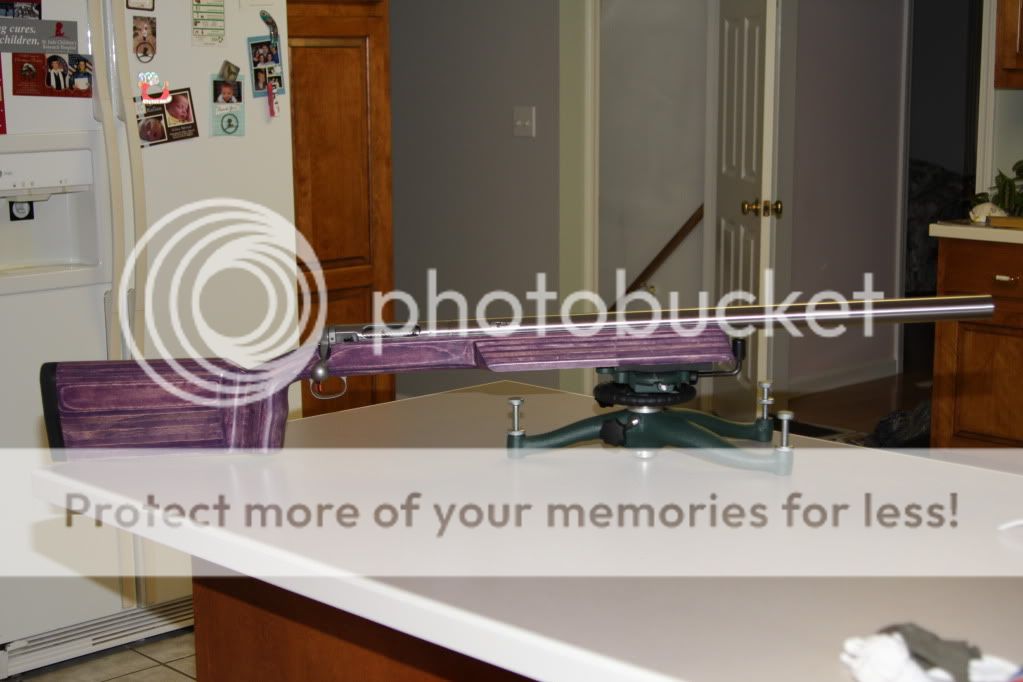

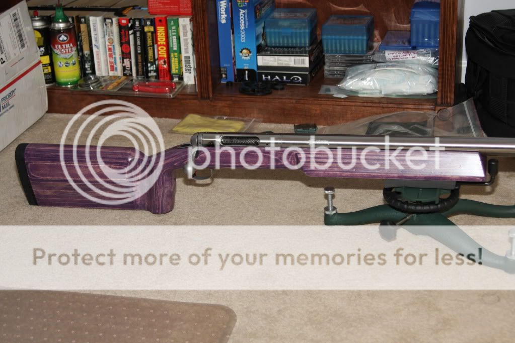

A heavy barrel Savage Target Action in .284 Win is going in this stock for now. I'll probably keep this stock around more for measurements and to tide me over for now.

great job on the stock. its more work than u thought at first wasnt it. well the next one will go much faster. one thing that ive found that helps a lot with the staining is to use pre stain conditioner. u can get a quart pretty cheap at homo depot or lowes and it makes all your staining blend together nice and it absorbs evenly. hope this helps

Actually, it wasn't bad at all. I'm already planning to make several more with the wood I already have and some higher end wood as well. I may even make one using laminated 3/4" Zebrawood. I saw the Zebrawood the other day at a custom wood shop and fell in love with it. Of course it's was the 2nd most expensive wood they sell.
I just finished filling the rear pillar and I'm making the butt plate now. Should be all done and assembled this weekend. I'll post some final pictures, pictures of all the tools I used, including the router bits, and answer any outstanding questions this weekend.

The stock is a little lighter than it appears in these last photos, but here it is. I made the butt plate out of a 1/4" stock spacer and some shock absorbing foam.
