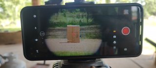

Just another odd thing I thought I'd try and I'll tell you this stuff isn't as easy as those big name YouTube personalities make it lol ! Decided I'd have a lil fun trying to do some reviews ( and I use that term lightly ) of these Chineseum scopes I like to pick up from time to time ( mainly because the reviews I see are either shills just trying to sell it off as the best thing ever , bubba who thinks anything thats semi better then a Walmart Bushnell is great or the scope snopes who hate anything that's not a $2000+ piece of German glass . Figure I could do something a lil better lol) and man trying to get footage though then that some what matches what you see your your actual eye is a bit of pain. Just trying to get the dang scope sat still and semi solid required a lil something ended up clamping a old stripped upper in my tripod then mounting the scope tho that then trying to film though that with my phone on a tripod and it works ok
But then trying to re adjust when you moved up in magnification was a bigger pain !
Even up finding one of the old relics of the past in the for of this telescope mount. Few years back this was the #1 way folk would film though there scopes
Still a bit hanky but easier to adjust and lock stuff down .
Deal is it never looks as good as it does though the naked eye... Anyone play with this type of stuff?
