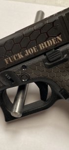

You’ll have to play with your number of loops and hatch settings. Every laser is a little different. a 45° and a -45° work well for me on steel engraving, a single 90° for annealing steel, a single 0° works best the Glock polymer settings engrave and clean up. Definitely don’t take these as gospel just changing your focus +/- 3mm will can drastically change things. my laser has a stepper motor on the z axis so when I deep engrave it will keep itself in focus. If yours is manual you’ll need to listen to it and adjust your focus as you cut deeper. I’d encourage you to join the laser everything discord server it’s like 8 bucks a month. I go a little more in-depth on some of my settings and how I do my slide wraps. I’ve not been on in a long time you can search my user name (KS505 or Killswitch505) there might even be some better stuff on the server now.

If you have any issue shoot me a pm and I’ll send you my number. what lenses did you get? I would highly recommend 70x70 100x100 and 200x200. 70x70 might seem small but it offers the most power. If you need an odd ball shim to time a muzzle brake and you want it to perfectly match your barrel diameter is where the 70x70 shines I don’t even stock shims anymore I just laser them out. Making lightning cuts on slides blah blah blah. The 200x200 is what tends to stay on the machine the most. You could make a decent living with the laser itself. I don’t really use mine for anything more than my NFA stuff. I wish my kids had some hustle in them they’d be rich just doing yeti cups and BS like that.
