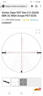

now i understand. i have vortex pst gen one and gen 2 ffp and they have thick bars like a duplex on low power a, yes the crosshairs become small but at close range you dont need the lines. they blend in to be just a bar.

maybe your leupold dont have the thicker bar? idk?
scope on 5x. see what i mean? you dont need the fine holdover lines at that range, they work just fine

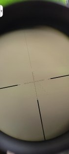

View attachment 1364188View attachment 1364190
Yes, I see what you mean. Yours is usable at low power. Mine have triangles at the sides that correspond to the crosshairs and I would not be comfortable with them at all.
