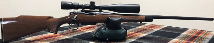

Yes it will. My 223 Ack Imp started life as a Rem 700 LTR 223 before I had it rebarreled/chambered in 223AI and the HS Prec det. mag setup bolted straight in.
My 20-222 also on a Rem 700 that one has a factory Rem walnut stock. I used the same exact HS Prec det. mag system on that rifle and it too was a straight bolt in replacement to the factory BDL hinged floor plate.
Those two are both five round mags and unless you're looking for it you don't really even notice they aren't factory BDL setups.
