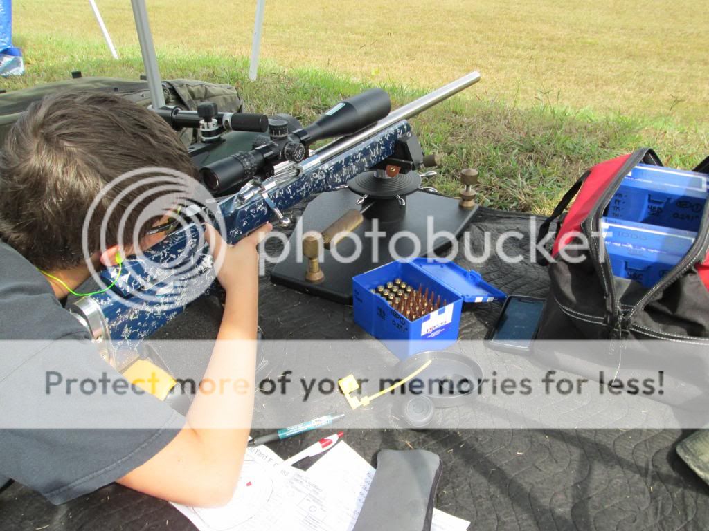

I have a 100mm Konus on my Pole Cat. No issues and my front rest is pretty large. This is the best pic I have with my 14yo son taking the line at 1000yds. Just a turn of the head and you are looking through the spotting scope.
