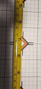

i just make my own with a ruler and marker, its just easy and just makes it easier to see where your nodes are
this was my 6BRX at 300m with 105gr hybrids and 2208/varget , i now use a red marker as your bullet holes don't get lost if they hit the black line.

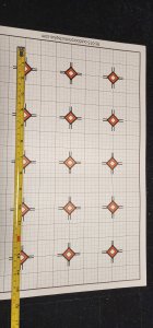

I prefer this style. I designed this one myself for 100 yard load development. The center dots are 1/4” which is the size of the floating dots in my Sightron scopes at either 20x or 24x. I can also adjust the dot size bigger or smaller to fit a particular reticle or scope power. I like to watch my point of impacts change in load development and having 6 targets in a row makes that easier to see and read for me. Having more in the same row would be better but I wanted to be able to print on standard 8.5x11 paper. I use card stock paper to print on and it makes a really nice durable target with clean bullet holes. The square box below the aiming points I fill in with the bullet jump for each target when doing seating depth testing or powder charge when testing powder charges. 2898D9D6-27B3-449E-AE31-99D84940CD26.png
Here is one which I use. The 1/2 diameter circle has a 0.218 white which allows a little white around a .125 dot. It is easy to center a dot in a small white circle. The squares are 1/4". I sometimes offset the impact point down to preserve the white circle.
I open the pdf on my computer and print the targets on my ink jet printer. I print them on the back of targets that I have purchased in large quantity, and have cut down to 8 1/2 X 11
I use the top and bottom two targets as sighters or cold bore shots. I use the upper corner to write in the gun I am using, large enough to read through the scope, and the lower righthand corner to record temperature, humidity, atmospheric pressure and general wind direction and speed. With 20 targets on each sheet, it saves a lot of running down range to change targets.
I record the data on a sheet that matches the targets. I record the Labradar data for each target after each 3 or 5 shot string. I also record the seat depth, and Labradar series number.
When I get home, I check the group sizes with On Target, and write on each target the load, seat depth, average velocity, ES, SD and group size. This target and the data sheet then go into a folder I have for each barrel.
