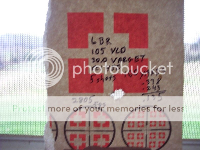

fastest load development ever,,6BR
I was told to start with the 105 VLD seated .010 in the lands and work up to 30.5 grs Varget,,
when I am working on a new load I size and prime all my brass and load 5 rounds at a time as I have a concrete bench and a 300 yard range just out my basement door about 60 feet from my load bench,,that way I can load and shoot 5 rounds and let rifle set on rest while I go inside and load 5 more and so on,,
this AM I set my rifle up and started with once fired brass from same rifle sized with Redding FL-S size die with .266 bushing and primed with CCI 450 primers,,
I started .5 grs below the recommended load and loaded 7 rounds at 30.0 grs Varget and seated the 105 VLDH orange box .010 in the lands and went out and fired 2 foulers as I cleaned bbl last night and shot one five shot group ,,after seeing that I went back in and loaded 5 more exactly the same and attached the magnetospeed to check speed and spread,,those 5 clocked 2795 to 2807 ,,
think I will just load 100 rounds and forget load workup and just practice shooting at 600 yards,,
I always heard the 6BR was easy to tune but this is almost hard to believe,,

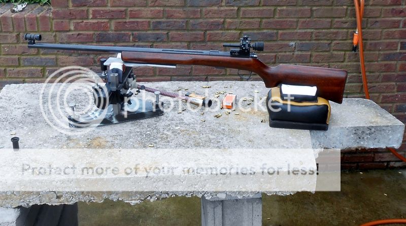

laid block and set a piece of sidewalk Grandpa poured in 1962 and notched with a concrete saw,,to say it is steady is an understatement,,figure it weighs close to 1,000 lbs,,
