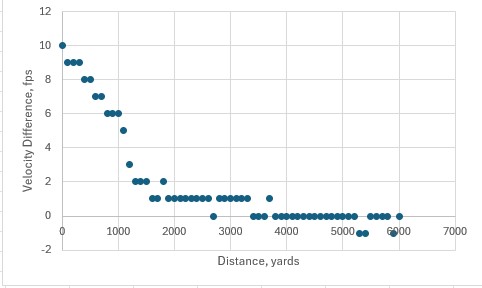

My latest way to abuse solvers is studying to death the effects of small changes in velocity and BC at ELR distances so I may have my nose in my own weeds. I see the speeding up effect you pointed out in the solvers, but it is an extremely small effect late in the game. Interesting, but not enough for the tortoise to ever catch the hare.
This is the difference in Velocities at each distance between the original 30 caliber example and a second bullet 10 fps faster.
The effect is there but appears very late and is so small a range card that only reports to whole fps doesn't always catch it.

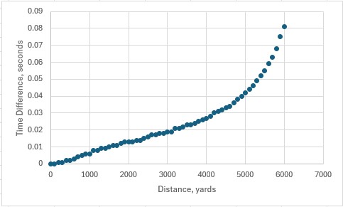

This is the difference in time to each distance.
The hare wins at every distance. It keeps pulling further ahead, faster, as the distance increases.
