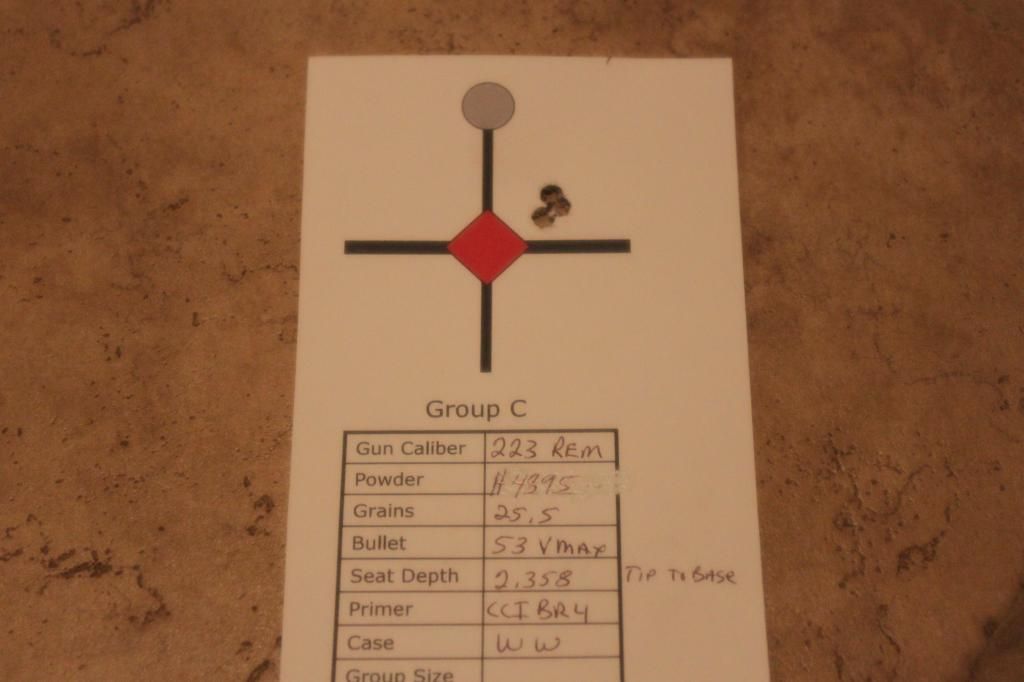

My next round of testing today. I loaded up some of the Lapua brass that I had fire formed this last weekend with 4 different charges of H4895 from 26.0 to 26.9 grains in .3 grain increments. I also shot some factory Fiocchi ammo to fire form some more brass to use later and shot my Savage B-Mag 17 WSM as well. I'll let the picture of the target show all the details.....
I think I may be just now coming into a node on the upper end of what I shot/tested today and I plan on doing a 300+ yard ladder test this weekend from 26.0 to 27.5 grains of H4895 in .3 grain increments and see what it tells me. I show no signs of pressure whatsoever yet so I'm sure I can go a few charges higher w/o any problems and maybe I'll get a nice load in the 3650-3700 FPS range that shoots accurately. All in all I'm pleased so far and I think once I really nail down my load and mess with some different seating depths I should easily find a load that's at or under 1/2 MOA, at least that's what I'm striving for.
