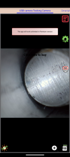

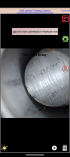

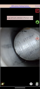

I just put on a new factory takeoff 6.5cm Tikka barrel.
I go to find the cartridge base to ogive length for shooting 140gr match burners and use my Hornady tool to do so. I sharpied up the bullet.
When I push the bullet with the rod up into the throat, it doesn't go very far. I pull it out and look and the bullet is abnormally deep in the case. I know the Tikka factory 6.5cm barrels have very long throats.
So I put it back in and push the rod a little harder and then it suddenly jumps further forward. I give it another firm push to make sure it's all the way in. I do that several times and each time it takes a firm push to get the bullet seated to the lands.
Looking inside with the scope, I see drag marks where the sharpie came off the bullet. All the way around the freebore.
Wtf.
Problem #1 I had with this barrel is that the headspace is short (that's ok I'll just handload for it) #2 is that it seems the freebore is tight.
Maybe this barrel was reamed with a worn out reamer? How did this pass the factory test shooting and inspection?
My question is ... Has anyone had a rifle with essentially zero freebore clearance and if you did, did you shoot it and did it shoot ok? Did it give excessive pressure signs with lower charges? Group horribly?

It looks like the freebore is rough, perhaps do to machining issues - worn reamer, wrong speeds, poor chip clearance, etc. That roughness will probably disappear after a few rounds are fired. The bullet appears to be making contact with only the high points in the freebore.
The several Tikka barrels I've looked at look pretty similar in the freebore. They generally seem kinda rough, but the bore and grooves are like mirrors.

This doesn't have a short throat. It has a very long throat. After pushing the Hornady tool rod a little harder and the bullet fully seated into the lands, there wasn't much bullet left in the case neck.
The issue is the freebore seems to be a smaller diameter than it should be.
6.5cm saami freebore diameter is .2645 with a tolerance of +0.002.
The bullet should not be contacting the freebore at all, but it does as evidenced by it hanging up pleasebefore seating into the lands and it leaving sharpie marks on the sides of the freebore portion

I had a similar issue with a barrel replacement (not a Tikka). A light touch with a throating reamer and some polishing and it was good to go. Although it appears rough and has some left over machining from the reamer it probably isn't as bad as the sharpie marks look. As we push the bullet with black in to find the lands the bullet will shift around a bit and hit the walls of the throat dragging off some of the black. If it were me and I didn't have access to a throating reamer, I would wrap some fine steel wool around a brush with some JB and polish the throat a bit. But, I'm a backyard Redneck gunsmith!!!

Well, maybe it'll shoot, tight freebore or not.
Ran a couple patches through the bore before leaving.
Started with the cheapest ammo on the shelf to smooth that throat. Winchester power points. Not good :/ 100yds.
Then went to my 140gr match burners loads. Starline SRP virgin brass, cci450, and 40.0gr h4350. Jumping around 0.110.
Keep in mind the wind was gusting, whipping left and right. I just held center.
25 shots. It will do :) I think the mantra "let the target decide" is right
