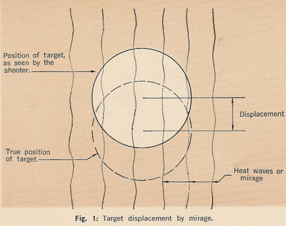

My understanding of the old prohibition against shooting in a boil is largely due to the concept of diffraction. As described in Snell's Law, light passing through two mediums of different density will have a different angle of incidence in each medium that is proportional to the density of each. An example of this is how a straw placed in a glass of water looks. Viewed from different directions, the regions of the straw above and below the liquid appear to be bent, or even separated, relative to one another.
Yet we know in reality that the straw is a single straight piece of plastic. Likewise in target shooting, the idea is that the differing densities of warmer and cooler air currents (i.e. "mirage", of which a "boil" is one type) can cause the target center to appear to be in one location through the scope, but in reality you're not aiming at the spot on the target face you think you're aiming at due to diffraction of the image.
While this phenomena clearly occurs, I do not have a good explanation for why I seem to shoot so well in a boil, when so many shooters over the years tell you specifically not to do that. My guess is that the actual displacement of the image when viewed through the rifle scope during a boil is not sufficient to move my true POA outside the X- and/or 10-ring. In that event, the effect of the boil condition for me is simply to take most, if not all, horizontal wind deflection out of the equation. In other words, for me it's more like shooting in a dead calm. I can imagine that my scope magnification (I rarely ever run the mag above 32X or so), and the specific conditions at the ranges I shoot most often may also be contributing factors. In other words, a "boil" condition at one range may actually be much worse than another, even though they might look the same to the shooter.

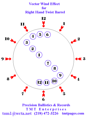

Some additional contributing factors responsible for elevation, wind direction, wind strength and rifle twist.
If you look at the wind vector chart you note a left to right wind pushes down while a right to left raises. In the absence of wind (a boil) the effect on the bullet is gone.
example: wind coming from the left requires 1/2min more of elevation. as seen in the diagram for 10-11-12 when the wind changes to a boil; compensating by aiming low reduces the chance of an elevated shot as you have taken off the extra elev previously added.
Right wind 1-2 the shot is reasonably centered or slightly high. Aiming low for right wind protects the 10 ring in a boil. if you estimated correctly the shot will come up a mid 10 where you aimed or an X or 10 if there was residual left wind.
light wind 1-3mph has less effect
