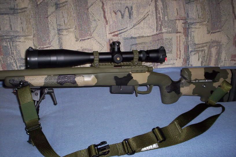

I have found that Tery Cross modifies the McMillan stock for an adjustable cheekpiece rather than use the McMillan one.
Here is an image,I hope) of my latest Terry Cross rifle showing his work and his cheekpiece. Also this is the GAP cammo pattern that McMillan does as well as the floorplate with magazines. Notice his work on the rear iron sight attachment.
