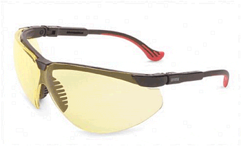

ESS, Pyramex, UVEX are all safety rated.
UVEX should be available in New Zealand and they should be very cheap. These are perfectly acceptable shooting eyewear -- better than some of the name shooting brands. Just keep them in a holder so the lenses don't get scratched. I recommend you get one clear set and a second yellow or brownish rose for bright days.
UVEX glasses meet ANSI Z87.1-2003, CSA Z94.3 and MIL-STD-662 standards. Uvex safety eyewear products are the world’s top-selling protective eyewear brand.
You'll have to pay a bunch more money to get something optically superior to the UVEX or ESS -- Something with custom-made Trivex lenses.
AVOID polarized lenses. The kill too much light -- you'll lose as much as 50% of the incoming light.

Most safety glasses manufacturers offer them with an antifog coating . 3M, Pyramex, N-Specs, Jackson, Smith & Wesson, Sperian, Uvex, Crews, Radians. All these are ANSI Z 87-1 impact rated. Most offer different colored lenses. A lot of manufacturers offer small frames which fit the smaller faces better. Northern Safety & Industrial has all these at good prices. 1-800-631-1246.
I do not work for this company, I buy from them as safety manager for a large sawmill company.

Also on the UVEX and the ESS and the Oakleys they are all made for military wich means they all meat 787+ and they can all accept perscription inserts that are made for them. And they are all made for extreme conditions and for shooting in those conditions.
UVEX is probably the best made for our application. Another big plus is that they are made right here in the USA ;) 8) I wonder how much additional money CHINA has added to our tab for supplying the OAKLEY glasses to our military :o :-[

If you can't find what you are looking for in the UVEX, I would be happy to send you a couple of them. I would however ask you to cover postage. We use them during the de-fueling/re-fueling at outage time in the nuke plants. We have found them to be the safest and most comfortable made.
