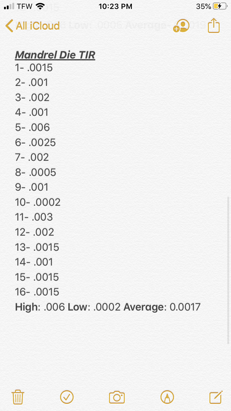

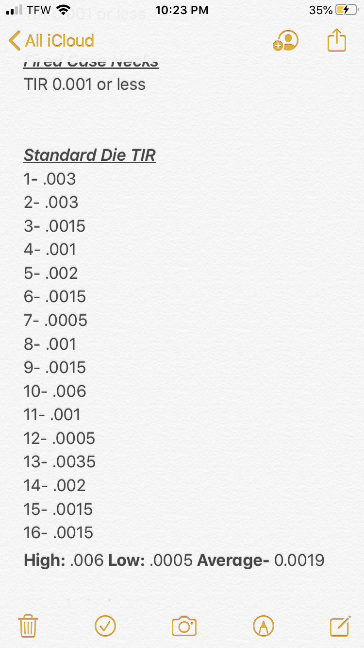

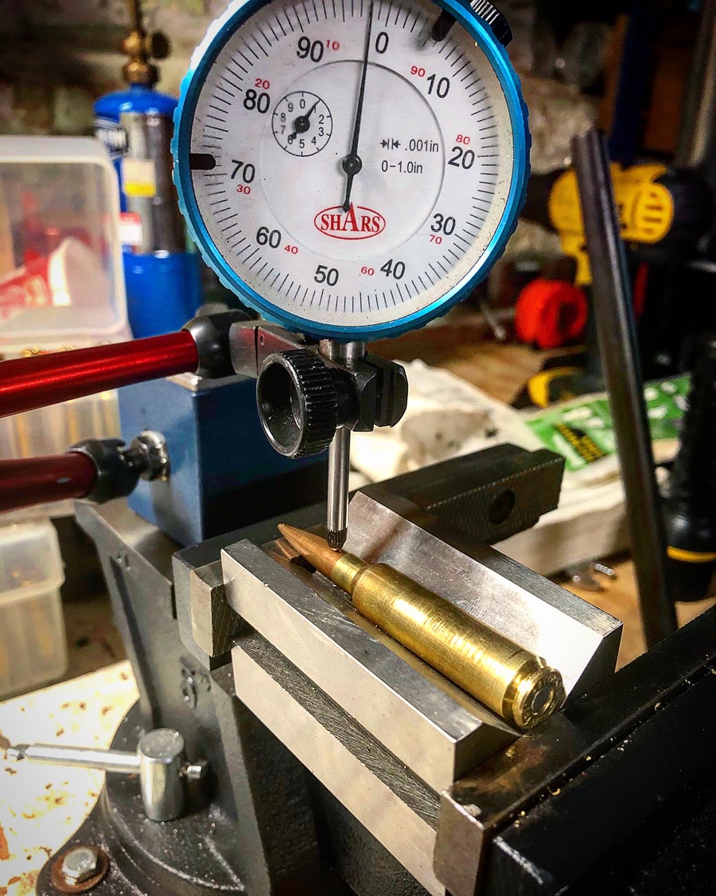

Major flaw in that test Uncle Ed..
For one, his source of runout, which is high, is not neck expansion, but poor bullet seating. Expansion does not fix a poor seating effort, so of course there was no fixing of it there.
There was .0002 bullet runout difference between using a expander die and a standard die with its expander in his test.
And all the bullets were seated with a standard Hornady seating die, so I would not say it was "poor bullet seating".
And I ran the same test using a Forster full length die and my Sinclair expander die using a Forster benchrest seating die and got very similar results.
