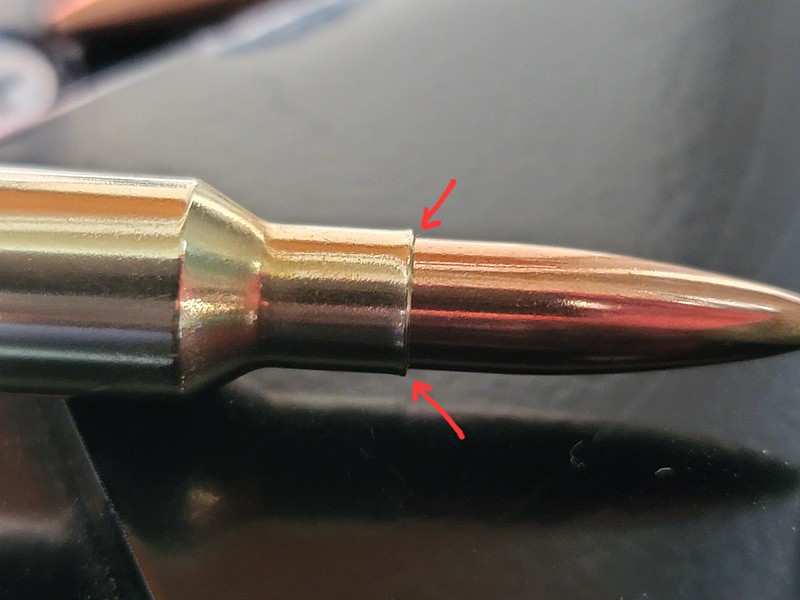

went to load for a match and bullets wont load, finally figured out it was the expander, ( i tested 2 different ones) and both flared the case neck.

the flare at the case mouth .320 (ill double check that ) will not allow bullet to chamber
i found it happens after expander process

I had a similar problem with a Mighty Armory FL sizing die. The expander button flared the case mouth, and that extra width of the lip on the case mouth hung up in the neck of the chamber and wouldn't allow the round to fully chamber or the bolt to close without slamming the bolt forward. It had nothing to do with tumbling or annealing because it still happened with zero tumbling and zero annealing. Chamfer/deburr and trimming had nothing to do with it, and bullets seated just fine with the flare.
It had something to do with the shape or position of the expander. It only happened when I used the factory expander. Firing the flared brass fireformed the flare away. Using the factory expander put the flare back in. No factory expander, no flare.
I switched to a honed Forster FL die w/o the expander assembly, and a 21st Century turning mandrel and the problem immediately went away.

I had this problem with a Mighty Armory FL sizing die. The expander button flared the case mouth, and that extra width of the lip on the case mouth hung up in the neck of the chamber and wouldn't allow the round to fully chamber or the bolt to close without slamming the bolt forward. It had nothing to do with tumbling or annealing because it still happened with zero tumbling and zero annealing. Chamfer/deburr had nothing to do with it, and bullets seated just fine.
I switched to a honed Forster FL die and a 21st Century turning mandrel and the problem immediately went away.
thats picture perfect of mine

well, its not the expander, has to be brass during the seating process.
full length sized and seated 2 different bullets with 2 different dies a wilson and whidden
and neither loaded, took a black marker around top of case neck and you can see where its rubbing

7) bullet won't chamber (after some discussion we've figured out that a live round won't chamber in the rifle, after posts trying to help figure out why a bullet wouldn't seat in a case...)
8) i found it happens after expander process (what does this mean, during the full length sizing the expander button being pulled back through the neck...or something else.)(What did the case mouths look like after this process???).
9) Dirty Dog posts and as a result it seems you might have removed the expander button from the Whidden full length size die???? and then used a mandrel in a separate operation to expand the neck???
10) After conducting the process in #9 the case mouths were okay???
11) Then you seated bullets in cases per #9 method and using two different manufactures (Whidden and WIlson) the case mouths were flared after the seating process was completed???
Question: What is the length of your cases? Have you trimmed?
