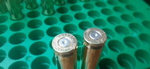

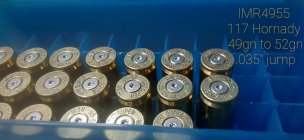

Excessive primer dimpling with CCI 450s.
Upon confirmation with my wife, she noted that the primers used in her 17 hornet loads are from the same case and that they in fact crater similarly with her loads. Perhaps it is a soft lot of primers?

1. Brass is twice fired. Purchased new( Alpha munitions), and only every fired in this rifle.
2. Barrel was properly installed, and headspace.
3. Cases are sized full length, shoulders are set back .002.
If you head spaced your barrel several thousandths longer than prior owner did on his rig - the 'slop', combined with being a stiff load, will enable the brass to slap the face of the bolt - giving the impression of a hotter round.
