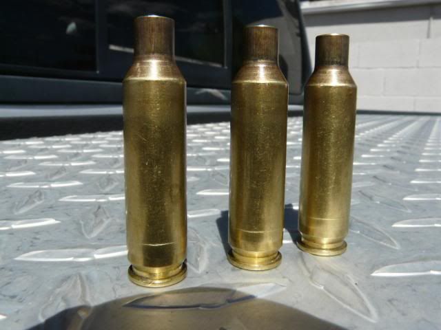

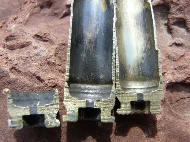

Also, given that the sidewalls are not stretched, the cases don't experience case head separation. Typical advice is to reload cases no more than five times in a Garand/M1a and toss the case. This is due to case head separation. These mechanisms are hard on cases but I took one set of LC 66 twenty three firings without a case head separation. These sectioned cases are mine, along the way, some cases experienced case neck splits, body splits, and I sectioned them to see what was going on in the interior. R refers to the number or times reloaded. R5 is five times reloaded, R22, twenty two times reloaded. The FAL case, which I think was once fired, or a couple times fired, in a buddy's FAL, shows obvious signs of case head separations.
Now this is what happens when you have the case sidewall carry load: the case stretches and fails.
These cases were fired dry, five times in a buddy's M1a. You can see why the advice to load five times and toss is good advice, if you fire dry cases in these actions.
