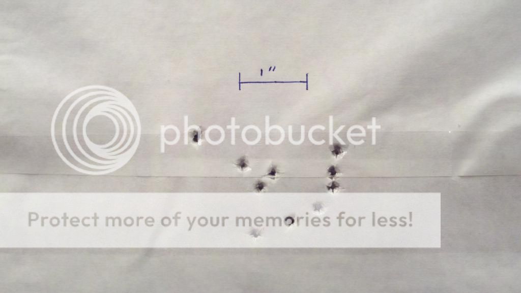

Then after changing targets I got started with the Berger 105 Target BT's that I loaded. First load was 34g of VV N150, 2.177OAL at Ogive (.018 off the lands) per Erik's direction on finding the lands. BR-2 primers, four times fired cases that were freshly annealed with primer holes de-burred (never done that before). Now I should tell you that Herb has this nifty camera set up that allows us to see the target on a screen while shooting so seeing your shots is easy.
What happened next I can not explain. According to OnTarget the 10 shot group at 600 yards measured 2.159". The nine shot group was 1.727". The 35P showed the following data. 2899/2885, M-2890, ES-14, SD-5.
Here is a picture of the group. I finally feel like things are getting somewhere. Thank you for all the help from you guys on here that have posted, e-mailed, pm'ed and called me!

Very nice group!
Joe. Indeed it is. Can you post a picture of the very nice rifle too? Thanks JCS
