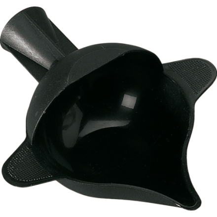

  6. Using satern powder funnel speicific to your caliber and reloading tray specific to your case dump powder into case then put bullet on top to signify the case has been charged
