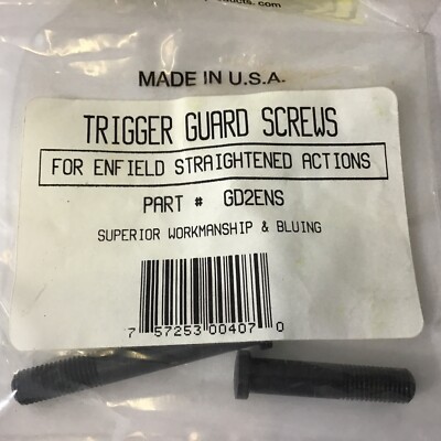

I've been building a 300 H&H on a Winchester 1917 Enfield action. I'm nearing the end of the project and have encountered a new issue. The stock I built for the rifle is considerably leaner than the one that was on it previously. What I've run into now is my front screw is 1/2" or so too long with the leaner forearm. The issue is that the screw is not threaded throughout the length, only the last 1/3 of it, so simply shortening the screw doesn't appear to be an option. Any suggestions are much appreciated.

1917 Enfields have a 1/4-30 thread. Not common, but you can probably get a die from Brownells, and extend the threads unless you can find a custom screw with more threads.
Yep, 1/4-30 on those.

Check out your local ACE hardware or stores like home depot. They have a good assortment of screws that have straight, philups,and hex heads .I have had good luck for sako, rem. And savage actions.
Get a 1/4-30 die and extend the thread on the original screw. Keep the die on the screw until you shorten it and then back the die off to clean the starting threads. I'd suggest getting a tap (ground threads) at the same time. MDX is good quality imported stuff. Tool And Equipment Sales Corp. is good to deal with on the MDX stuff...they have an ebay store.

As for buying a proper die, and running the screw in to add additional threads, I thought about that, but I wasn't sure how to secure the screw while turning the die, or vice versa, without boogering the head...if that makes sense. I only have the one screw, need to get it right the first time.
I have made quite a few action screws from "Screw Blanks"
I have a box half full of them that I believe were made by Clymer Reamer company, Brownells used to sell them and they still might.
Many times you can fit them inside of a 5C collet by sliding them in from the rear of the collet up to the head and thread them on the lathe.
Yep. They still offer them. Another use for them is an endless supply of blanks for making odd size/depth roll pin starters, sacrificial pins, and slave pins.
