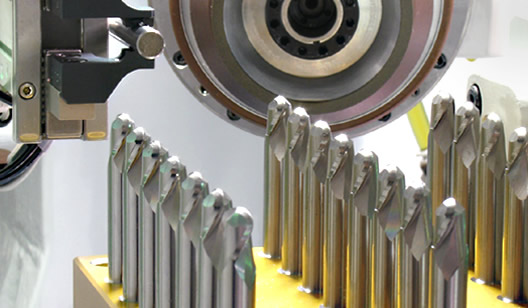

Here’s some:
In the middle of the 1960s I sharpened tooling on an old KO Lee. It taught me that a great tooling shop is the way to go with no more than I use now.
I've used Marcus for about 25yrs for regrinds, special tools, and wire EDM work. His tool grinders are CNC and not the old KO Lees.
