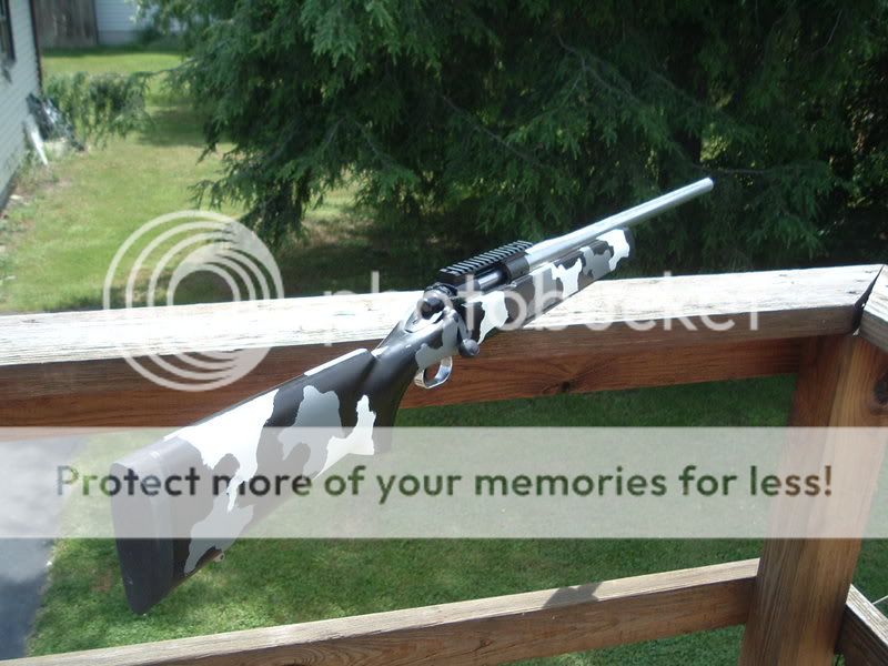

The 243 Win.
and
and
Specs.
Chambered for the 243 Win
M700 SA.
Pacific bolt .0025 under.
McMillian HBR stock, Gap camo white gray and black.
Rock 1 and 8 twisted Sendero, finish at 28 inches
Rifle Basic trigger at 10oz.

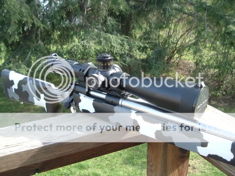

Seekens 20 MOA rail
Seekens 34mm rings

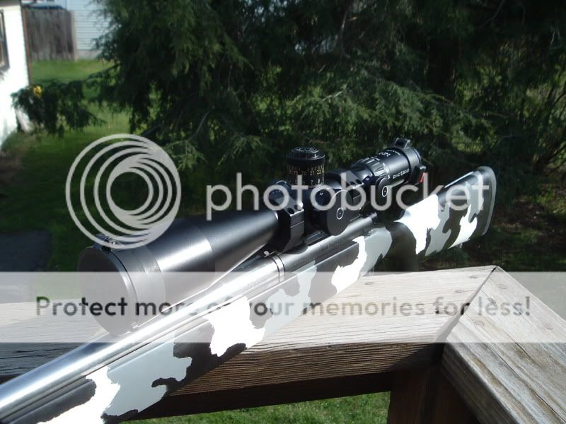

Schmidt and Bender 5-25x56 PMII P3Fine reticle
and

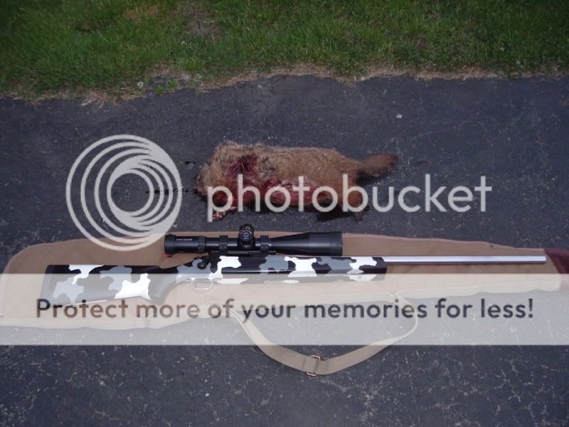

My first purpose built heavy per caliber rifle.I've been running 115g DTACS and 105g Amax bullets the Amax bullets get the nod.At least so far.

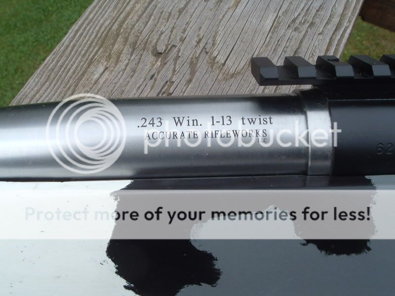

I think Randy at Accurate Rifle Works did a fine job.
Thats not the barrel thats on it now.Its got a 1-8 on it now.
Close up of the bolt.
My Model 33 is telling me that the 45.5g of Reloader 22 with Wolf primers in Lapua cases is getting me 3270 FPS on the 105g Amax.
If I do my part it will run .3 moa.
Last two shots to check/set zero on the scope before we put
Elsie to work.
This guy is not sleeping in my driveway.
Hes dead.

The 105g AMAX is fine shooting bullet only problem right now seems to be getting them.My buddie DonKnows used this 243 to drill a couple of chucks the other night.This amax puts a window in a woodchuck.Nasty big hole.Almost to the point of cutting them in half.
Little strip of hide top and bottem and a big hole in the middle.
A Texas Chainsaw Massacre with every pull of the trigger.The pic up top does not do justice to the hole you see there.Unreal.
Cant see myself usuing this round on a deer.No way.

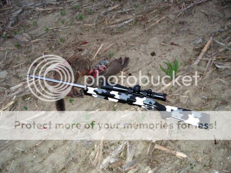

Mr.Woodchuck decided to come out for a little nibble of grass tonight just as I was finishing up.I managed to keep him in the scope as the the rifle fired and I saw the impact.
These Amax bullets are explosive.I think thats the word i'll use.The chuck I shot tonight was about 150 yards away and I did see the crap fly.That was my intent by installing the brake in the first place.

The smaller of the two suffered his own little personalized nuclear holocaust with him being flipped up in the air about four feet with accompanying mushroom cloud of brown dust and red mist.The 105 Amax puts a window in a 10 lb. chuck.The hits on smaller chucks are spectacularly violent.
