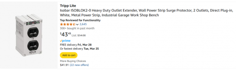

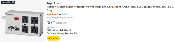

A basic RFI/EMI noise filter can be very cheap or cost more depending on the level of protection and the quality of the filters. Just punch in EMI/RFI multi-outlet in your search bar and take your pick. Here are examples of cheap ones.
How much you spend, depends on how bad your risks run. The more filter performance you need, the more you will spend.

When my scale went wonky this board offered advice that worked. I did three things, one of which was install a line conditioner. I overthought it on Amazon reviews and Youtube videos. Finally settled on a Tripp Lite kinda like the above but I think mine set me back $100-$120. Probably got more than I need. I think moving the regular cheap splitters on my bench further away from the scale and cleaning the stray powder kernels under the plate probably did more to help but who knows. Works perfect now though.
I ordered a Tripp-Lite. Really wasn't concerned to much with cost. I want to protect my scales and have them work at their best. Thanks all for your input. Brian.
