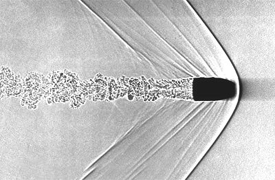

A rain drop cannot slide off of a shock wave - it is not a piece of window glass. The shock wave travels at almost 1,100 fps, rain drops fall at 30 feet a second. The shock wave passes through the rain drop(s)... all of them.

Vapor trails are caused from what happens after the bullet passes - the shock wave does not get in front of the bullet - it is formed on the nose and falls behind it.

http://upload.wikimedia.org/wikipedia/commons/c/c3/Bullet_Wiki.ogv
you were saying?

... exactly what I was saying.
That is the compression wave from the pistol shot - it is NOT the shock wave from the bullet - the bullet is not making that wave.
You need to know how to read these things.
+++ 1 on Catshooters post. And the faster the projectile the further back from the tip is the wave. Also, the wave is swept back at more of an angle. That is why the faster the airplane, the more swept the wings....to the point where they use the delta wing design.
