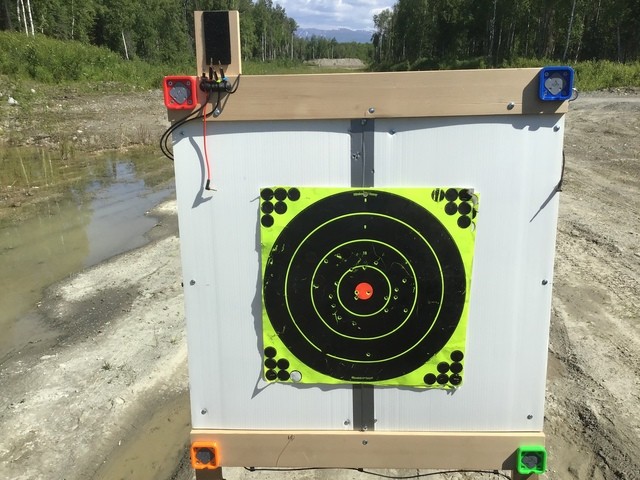

The waves were not bad at 600 yds when we started yesterday at 10:00, but in the middle of the afternoon they were. I just wait for a lull if I can, average 'em out if I can't. The problem is I have to wait for the lulls in the breeze, too, but the mirage gets worse when the breeze lays. :)
Rifle was a factory 700 Varmint w/ a 15-55 Comp on it. I cranked the mag ring until the picture seemed to be ideal, and that turned out to be 47x, close to the 50x you like. All shots except the one low one went into about a 7" circle, so I was happy. I knew I had one in the box that was short on powder but I had no way to find it other than by shooting. :)
One of the holes on the left side on the red bull was already there, so it looks like I fired about 18 rounds. The back nine were much better than the front nine, proving I needed the practice.
