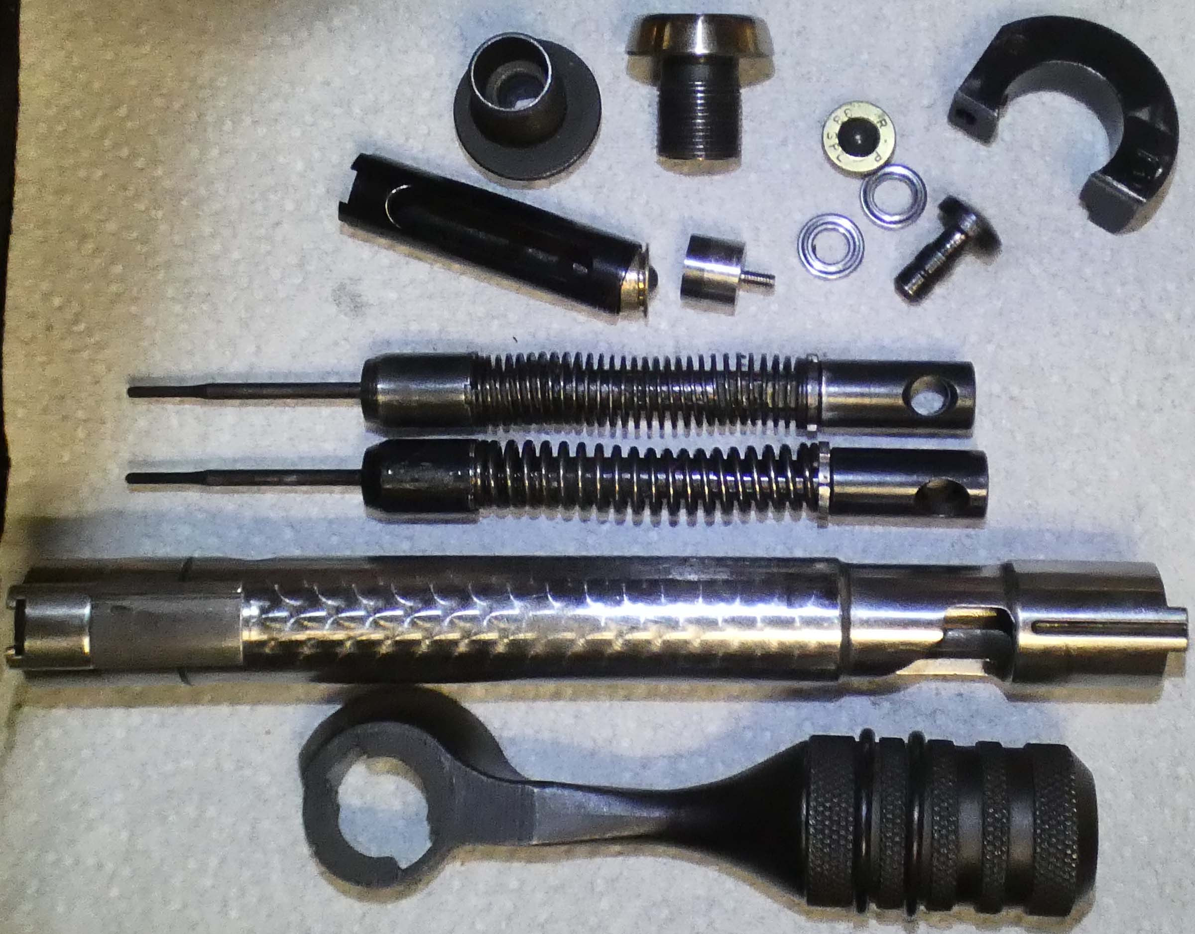

Here's a single shot from a F-Class Savage (notorious for heavy lift).
Bolt cocking ramp mod, firing pin spring change, trigger mod, and Carbide against Silicon Nitride bolt lift mod.
Not as light as some bench rest guns but a lot better than a stock Savage.
What I'd give to have a bolt lift like that!!
I think it's pretty good, considering it's a Savage :)
Wife likes it but she is new to bolt guns coming from an AR.
I like experimenting and playing with parts.

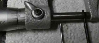

I don't think I need to look into bushing the bolt head.
Pin measures 0.0687", bolt head passes a 0.072" (-) pin but not a 0.073"(-) pin.
Pin fall is greater than a stock Savage Bolt. Pin cocking piece counterbored to shorten pin and increase pinfall. See previous picture of stock/modified pin.
This required a little work on the cocking slot.
The small parts shown in my previous post show a "New" style BAS, a 10mm Carbide micrometer tip, a 38cal mod with a Silicon Nitride ball (7/32" and 1/4" balls).
The bearing races are 10mm from ebay (not from a lift kit) and can be inserted under the micrometer tip to increase/decrease spring preload.
The Carbide tip in the new style BAS is 0.080" SHORT. I shaved down BAS length about 0.065". The 38SPL brass case/Ceramic ball can be made from a low of about 0.050" to about 0.090" giving a wide range of added internal preload.
The spring is an EGW Commander flat wound spring with firing pin preload shortened by counterboring the cocking piece about 2 threads.
I am not a gunsmith and this Savage was put together in the kitchen for the wife.
The big parts came from:
SSS for the pretty blue stock, inlet for the Savage as a single shot,
The action from NorthLand,
The 28" SM 1:7, barrel from Shilen, through Northland,
(sent in 3 dummy 22 Nosler rounds loaded a little long with Berger 85.5s)
Small parts from GunShack and Midway.
Most of my bolt gun knowledge came from reading past posts on a couple different forums.
The new style BAS and 10mm micrometer tip is my idea (I think), everything else can be found in old posts. Since it is 0.080" short a bolt lift 38SPL mod can be made with very little change to preload or shimmed up.

I picked Savage for the wife's gun based on what I could do in our Kitchen Armory without using a real smith. Tried to make the NEW Style firing pin work, contrary to recommendations. Finally gave up on it and went with old style and the adjustable pin.
Went with 22 Nosler as that's what we are stocked up on (both were using 22N AR's).
I think once you smooth action parts and install the Bolt Lift Kit of your choice ( my way is best :) ) any further reduction in bolt lift will require secrets of an expert with your brand.
